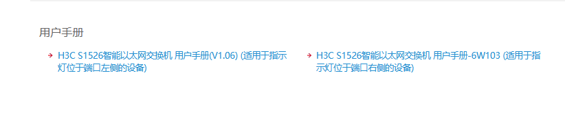

http://www.h3c.com/cn/d_200807/609757_30005_0.htm#_Toc202842144
http://www.h3c.com/cn/Service/Document_Software/Document_Center/Switches/Catalog/S1500/S1526/ 选择相应型号交换机。
