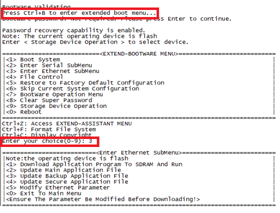

MSR830[930][2600]-WiNet(V5)系列路由器boortrom界面升级方法.docx
#在设备出厂前,管理口的IP地址为192.168.1.1/24。可将电脑直连此接口上,并设置相同网段的IP地址。(本案例电脑直连G0接口,实际组网中也可以使用别的接口)。
#Console线如何连接设备,可参考1.1.1 Console方式登录设备方法“Console登录设备方法”章节。
#在设备启动过程中,当命令行界面出现“Press Ctrl+B to enter extended boot menu...”时,电脑立即键入<Ctrl+B>,按下<Enter>键后,系统将进入BootWare主菜单在BootWare主菜单下键入<3>,可以进入以太网口子菜单,系统显示如下:。
 #键入<5>进入以太网口配置菜单
Enter your choice(0-5): 5
==========================<ETHERNET PARAMETER SET>==========================
|Note:       '.' = Clear field.                                            |
|            '-' = Go to previous field.                                   |
|          Ctrl+D = Quit.                                                  |
Protocol (FTP or TFTP) :tftp
Load File Name         :MSR2600-CMW520-R2516P19.bin
Target File Name       :MSR2600-CMW520-R2516P19.bin
Server IP Address      :192.168.1.2
Local IP Address       :192.168.1.1
Gateway IP Address     :0.0.0.0
#回到以太网菜单后,选择<2> 升级主应用程序,等待版本下载完成
 #键入<5>进入以太网口配置菜单
|          Ctrl+D = Quit.                                                  |

操作方法是正确的,但总是报错,提示:Something wrong with the file.,情况如下:
*                   H3C MSR830 BootWare, Version 1.61                      *
Copyright (c) 2004-2019 New H3C Technologies Co., Ltd.
Compiled Date       : May  5 2019
CPU ID              : 0xa
CPU L1 Cache        : 32KB
CPU L2 Cache        : 256KB
Memory Type         : DDR3 SDRAM
Memory Size         : 1024MB
Flash Size          : 256MB
PCB Version         : 2.0
BootWare Validating...
Image program does not exist.
Password recovery capability is enabled.
Note: The current operating device is flash
Enter < Storage Device Operation > to select device.
==========================<EXTENDED-BOOTWARE MENU>==========================
|<1> Boot System                                                           |
|<2> Enter Serial SubMenu                                                  |
|<3> Enter Ethernet SubMenu                                                |
|<4> File Control                                                          |
|<5> Restore to Factory Default Configuration                              |
|<6> Skip Current System Configuration                                     |
|<7> BootWare Operation Menu                                               |
|<8> Skip Authentication for Console Login                                 |
|<9> Storage Device Operation                                              |
|<0> Reboot                                                                |
Ctrl+Z: Access EXTENDED ASSISTANT MENU
Ctrl+C: Display Copyright
Ctrl+F: Format File System
Enter your choice(0-9): 3
==========================<Enter Ethernet SubMenu>==========================
|Note:the operating device is flash                                        |
|<1> Download Image Program To SDRAM And Run                               |
|<2> Update Main Image File                                                |
|<3> Update Backup Image File                                              |
|<4> Download Files(*.*)                                                   |
|<5> Modify Ethernet Parameter                                             |
|<0> Exit To Main Menu                                                     |
|<Ensure The Parameter Be Modified Before Downloading!>                    |
|         Ctrl+D = Quit.                                                   |
Protocol (FTP or TFTP) :tftp tftp
Load File Name         :MSR800-CMW520-R2516P24.BIN
Target File Name       :MSR800-CMW520-R2516P24.BIN
Server IP Address      :192.168.1.210 192.168.1.2
Subnet Mask            :255.255.0.0
Enter your choice(0-5): 2
Loading.....................................................................
...........................Done.
24258560 bytes downloaded!
