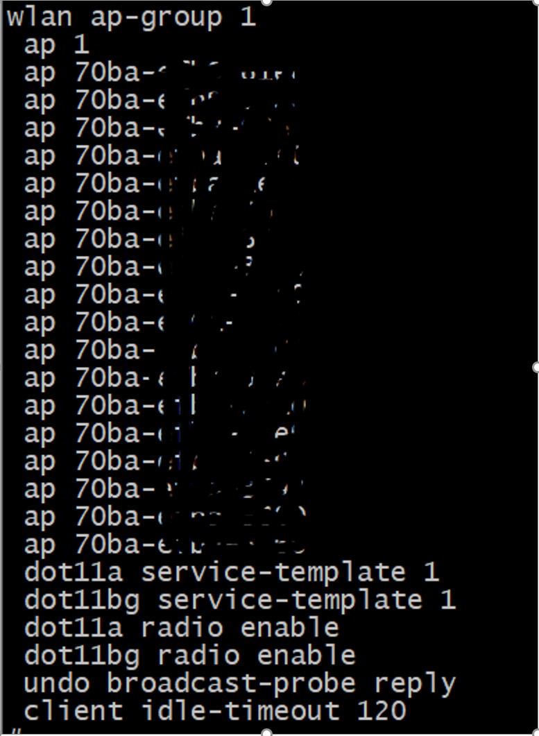

公司AC自从修改过之后一直有问题,协议协商一直卡在802.11a这,速率提不上去。下面是图片为ac上看到的客户机详细。近距离!
AC的配置如下,请问哪里有问题?
粉丝:116人 关注:0人

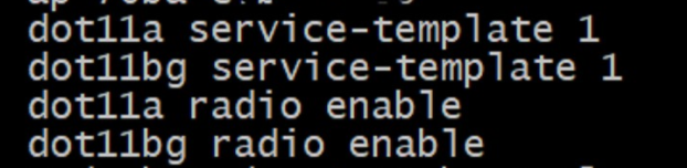

只绑定了11a和11bg
可以吧11an和ac绑定下:

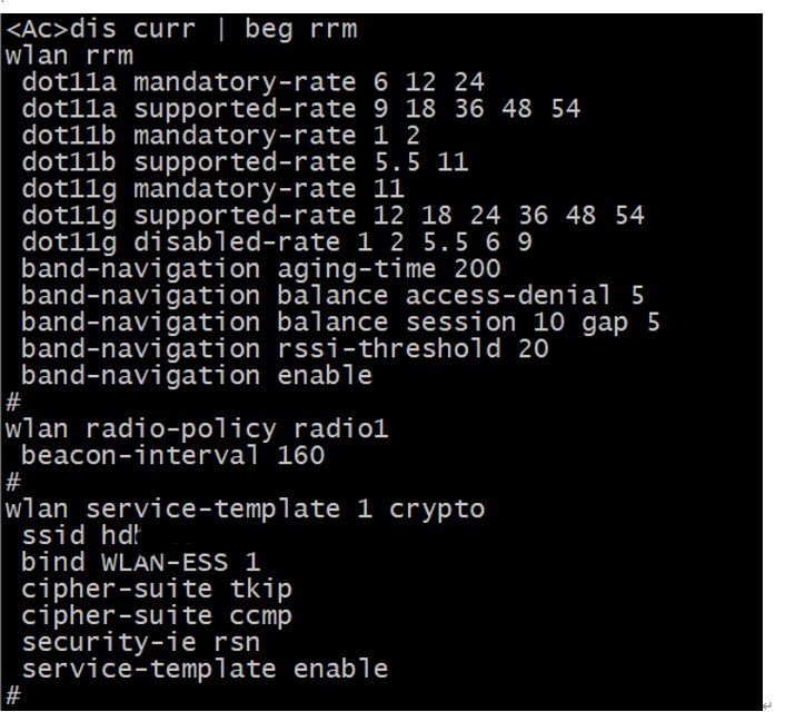

同时把下面这个配上:
# 配置信标和探查帧携带WPA IE信息。
<Sysname> system-view
[Sysname] wlan service-template 1 crypto
[Sysname-wlan-st-1] security-ie wpa

wlan rrm
dot11a mandatory-rate 6 12 24
dot11a supported-rate 9 18 36 48 54
dot11b mandatory-rate 1 2
dot11b supported-rate 5.5 11
dot11g mandatory-rate 11
dot11g supported-rate 12 18 24 36 48 54
dot11g disabled-rate 1 2 5.5 6 9
band-navigation aging-time 200
band-navigation balance access-denial 5
band-navigation balance session 10 gap 5
band-navigation rssi-threshold 20
band-navigation enable
wlan radio-policy radio1
beacon-interval 160
ssid hd
bind WLAN-ESS 1
cipher-suite tkip
cipher-suite ccmp
security-ie rsn
service-template enable
wlan service-template 2 crypto
ssid da
bind WLAN-ESS 2
cipher-suite tkip
security-ie rsn

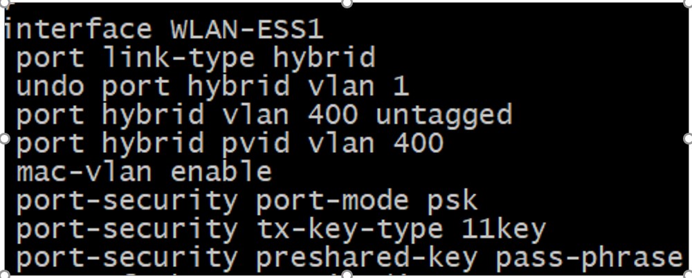

interface WLAN-ESS1
port link-type hybrid
undo port hybrid vlan 1
port hybrid vlan 400 untagged
port hybrid pvid vlan 400
mac-vlan enable
port-security port-mode psk
port-security tx-key-type 11key

dot11a service-template 1
dot11bg service-template 1
dot11a radio enable
dot11bg radio enable
undo broadcast-probe reply
client idle-timeout 120

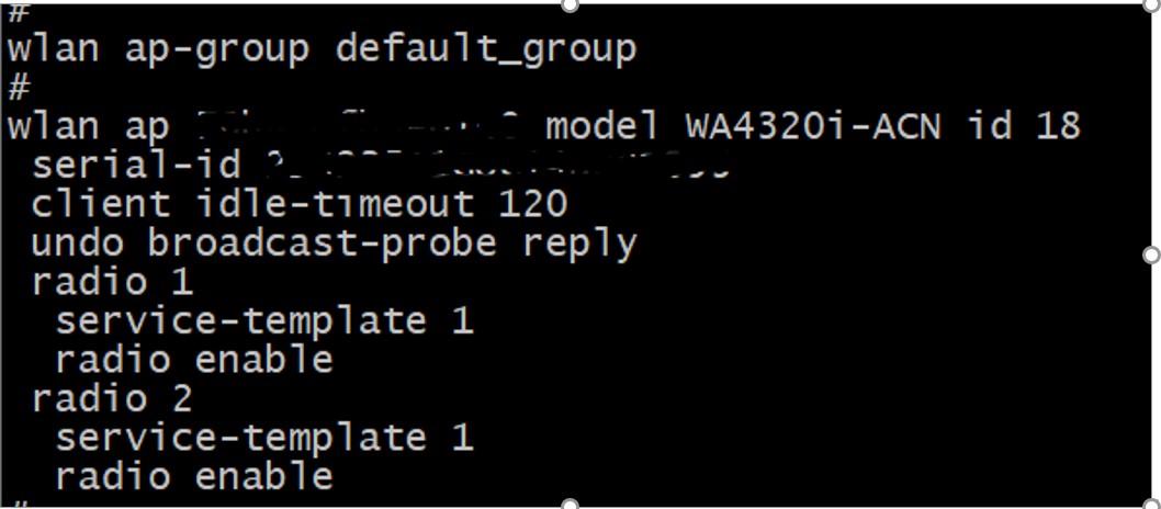

wlan ap 70ba-efb9-61e0 model WA4320i-ACN id 18
serial-id 210235A1GQC14B001895
radio 1
service-template 1
radio enable
radio 2
service-template 1
radio enable
