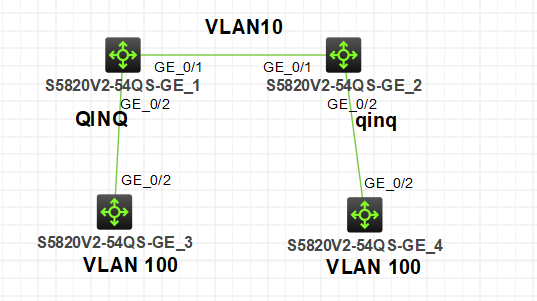

%Feb 25 21:37:58:562 2021 sw1 LLDP/5/LLDP_PVID_INCONSISTENT: PVID mismatch discovered on GigabitEthernet1/0/2 (PVID 10), with SW3 GigabitEthernet1/0/2 (PVID 1).
 [sw1-GigabitEthernet1/0/2]dis this
 # interface GigabitEthernet1/0/2
 port link-mode bridge
 port link-type trunk
 port trunk permit vlan 1 10
 port trunk pvid vlan 10
 qinq enable
 combo enable fiber #
日志打印这个是我配置有问题吗

日志信息是pvid不匹配,
这个日志只是端口的PVID和对端的PVID不一致而已。
