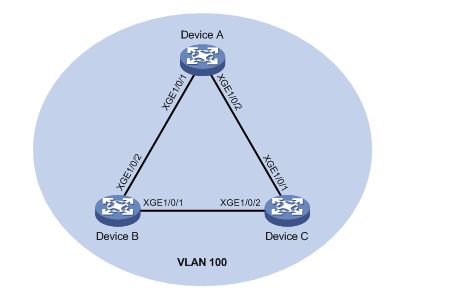

1. 组网需求
·              三台设备Device A、Device B和Device C组成一个物理上的环形网络。
·              通过在Device A上配置环路检测功能,使系统能够自动关闭Device A上出现环路的端口,并通过打印日志信息来通知用户检查网络。
2. 组网图
图1-3 环路检测典型组网图
3. 配置步骤
(1)      配置Device A
# 创建VLAN 100,并全局使能该VLAN内的环路检测功能。
<DeviceA> system-view
[DeviceA] vlan 100
[DeviceA–vlan100] quit
[DeviceA] loopback-detection global enable vlan 100
# 配置端口Ten-GigabitEthernet1/0/1和Ten-GigabitEthernet1/0/2为Trunk类型,并允许VLAN 100通过。
[DeviceA] interface ten-gigabitethernet 1/0/1
[DeviceA-Ten-GigabitEthernet1/0/1] port link-type trunk
[DeviceA-Ten-GigabitEthernet1/0/1] port trunk permit vlan 100
[DeviceA-Ten-GigabitEthernet1/0/1] quit
[DeviceA] interface ten-gigabitethernet 1/0/2
[DeviceA-Ten-GigabitEthernet1/0/2] port link-type trunk
[DeviceA-Ten-GigabitEthernet1/0/2] port trunk permit vlan 100
[DeviceA-Ten-GigabitEthernet1/0/2] quit
# 全局配置环路检测的处理模式为Shutdown模式。
[DeviceA] loopback-detection global action shutdown
# 配置环路检测的时间间隔为35秒。
[DeviceA] loopback-detection interval-time 35
(2)      配置Device B
# 创建VLAN 100。
<DeviceB> system-view
[DeviceB] vlan 100
[DeviceB–vlan100] quit
[DeviceB] interface ten-gigabitethernet 1/0/1
[DeviceB-Ten-GigabitEthernet1/0/1] port link-type trunk
[DeviceB-Ten-GigabitEthernet1/0/1] port trunk permit vlan 100
[DeviceB-Ten-GigabitEthernet1/0/1] quit
[DeviceB] interface ten-gigabitethernet 1/0/2
[DeviceB-Ten-GigabitEthernet1/0/2] port link-type trunk
[DeviceB-Ten-GigabitEthernet1/0/2] port trunk permit vlan 100
[DeviceB-Ten-GigabitEthernet1/0/2] quit
(3)      配置Device C
# 创建VLAN 100。
<DeviceC> system-view
[DeviceC] vlan 100
[DeviceC–vlan100] quit
[DeviceC] interface ten-gigabitethernet 1/0/1
[DeviceC-Ten-GigabitEthernet1/0/1] port link-type trunk
[DeviceC-Ten-GigabitEthernet1/0/1] port trunk permit vlan 100
[DeviceC-Ten-GigabitEthernet1/0/1] quit
[DeviceC] interface ten-gigabitethernet 1/0/2
[DeviceC-Ten-GigabitEthernet1/0/2] port link-type trunk
[DeviceC-Ten-GigabitEthernet1/0/2] port trunk permit vlan 100
[DeviceC-Ten-GigabitEthernet1/0/2] quit
4. 验证配置
当配置完成后,系统在一个环路检测时间间隔内在Device A的端口Ten-GigabitEthernet1/0/1和Ten-GigabitEthernet1/0/2上都检测到了环路,于是将这两个端口自动关闭,并打印了如下日志信息:
[DeviceA]
%Feb 24 15:04:29:663 2011 DeviceA LPDT/4/LOOPED:Slot=1;
 Loopback exists on Ten-GigabitEthernet1/0/1.
%Feb 24 15:04:29:667 2011 DeviceA LPDT/4/LOOPED:Slot=1;
 Loopback exists on Ten-GigabitEthernet1/0/2.
%Feb 24 15:04:44:243 2011 DeviceA LPDT/4/RECOVERED:Slot=1;
 Loopback on Ten-GigabitEthernet1/0/1 recovered.
%Feb 24 15:04:44:248 2011 DeviceA LPDT/4/RECOVERED:Slot=1;
 Loopback on Ten-GigabitEthernet1/0/2 recovered.
使用display loopback-detection命令可以查看Device A上环路检测的配置和运行情况:
# 显示Device A上环路检测的配置和运行情况。
[DeviceA] display loopback-detection
Loopback detection is enabled.
Loopback detection interval is 35 second(s).
No loopback is detected.
由此可见,Device A上并未显示在端口Ten-GigabitEthernet1/0/1和Ten-GigabitEthernet1/0/2上检测到环路,这是由于环路检测功能运行在Shutdown模式下,端口Ten-GigabitEthernet1/0/1和Ten-GigabitEthernet1/0/2上出现环路后均已被自动关闭,因此这两个端口上的环路已消除。此时,使用display interface命令分别查看Device A上端口Ten-GigabitEthernet1/0/1和Ten-GigabitEthernet1/0/2的状态信息:
# 显示Device A上端口Ten-GigabitEthernet1/0/1的状态信息。
[DeviceA] display interface ten-gigabitethernet 1/0/1
 Ten-GigabitEthernet1/0/1 current state: DOWN (Loopback detection down)
# 显示Device A上端口Ten-GigabitEthernet1/0/2的状态信息。
[DeviceA] display interface ten-gigabitethernet 1/0/2
 Ten-GigabitEthernet1/0/2 current state: DOWN (Loopback detection down)
由此可见,端口Ten-GigabitEthernet1/0/1和Ten-GigabitEthernet1/0/2均已被环路检测模块自动关闭。
