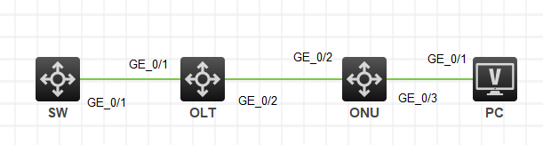

如何开启ONU的telnet功能
现有配置:
interface Onu1/0/1:1
 bind onu-id 7057-bf4f-eb9a
 undo shutdown management-vlan-interface
 ip address 192.168.0.240 255.255.255.0 gateway 192.168.0.1
 uni 1 port-isolate
 uni 1 vlan-mode tag pvid 100
 port link-type trunk port trunk permit vlan 1 100
interface Olt1/0/1
 using onu 1
 port link-type hybrid
 port hybrid vlan 100 tagged
 port hybrid vlan 1 untagged
 开启telnet服务和创建登录账号密码

通过OLT配置ONU,如果这么配那不是用户创建的是OLT的用户吗?

ONU上已经手工指定IP了,还需要配置什么吗?
