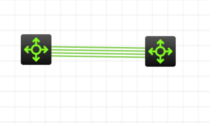

模拟器中,两台交换机做irf,端口总是down掉,dis irf 也只能看到本台机器是master
2021-03-19提问
  • 1收藏,2251浏览
interface range Ten-GigabitEthernet 1/0/49 to Ten-GigabitEthernet 1/0/52
 shutdown
 qu
irf member 1 renumber 1
 irf member 1 priority 32
irf-port 1/1
 port group interface Ten-GigabitEthernet 1/0/49
 port group interface Ten-GigabitEthernet 1/0/50
 port group interface Ten-GigabitEthernet 1/0/51
port group interface Ten-GigabitEthernet 1/0/52
 irf-port-con ac
undo shutdown
interface range Ten-GigabitEthernet 2/0/49 to Ten-GigabitEthernet 2/0/52
 shutdown
 qu
 irf member 1 renumber 2
 reboot
 irf member 2 priority 1
irf-port 2/2
 port group interface Ten-GigabitEthernet 2/0/49
 port group interface Ten-GigabitEthernet 2/0/50
port group interface Ten-GigabitEthernet 2/0/51
port group interface Ten-GigabitEthernet 2/0/52
 irf-port-con ac
 undo shutdown
