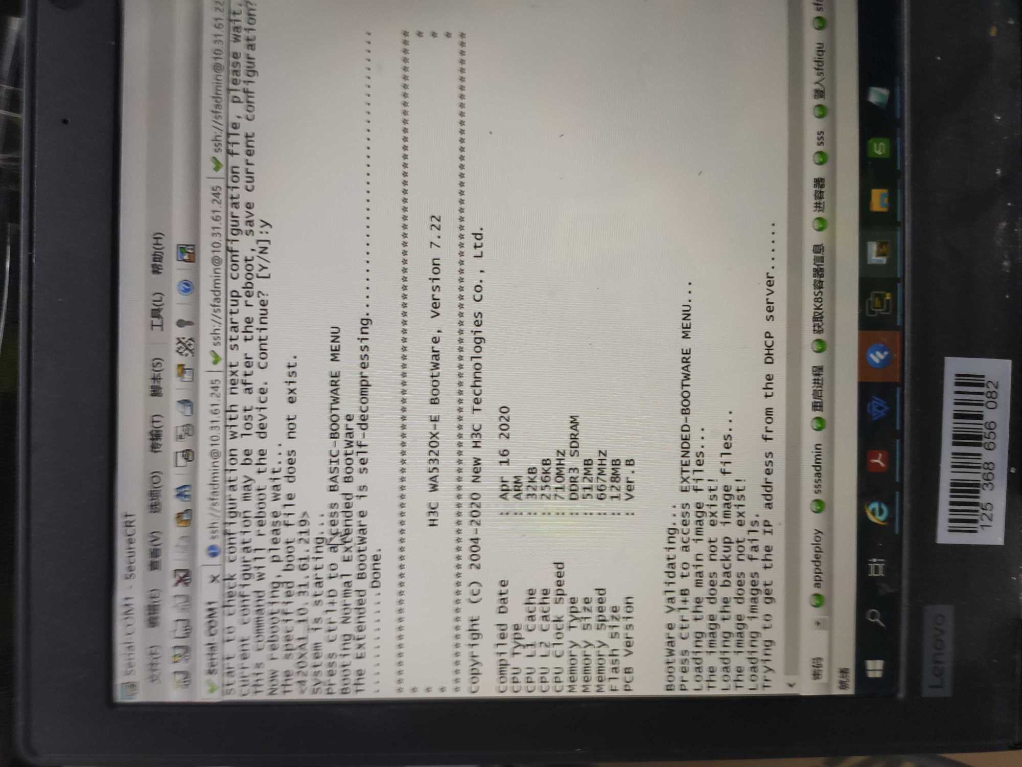

Wa5320X-E敲format flash之后清空配置后卡在重启界面

版本文件被你格式化了,重新上传版本文件吧
参考这个链接,bootware手动升级 https://www.h3c.com/cn/d_202010/1347147_30005_40.htm#_Toc51679399

B.2 通过BootWare方式手动升级 1. 进入BootWare主菜单 AP设备上电和重新启动的过程中,在配置终端的屏幕上首先将显示: System is starting... Press Ctrl+D to access BASIC-BOOTWARE MENU... Booting Normal Extended BootWare The Extended BootWare is self-decompressing....Done. **************************************************************************** * * * H3C WA6320 BootWare, Version 7.13 * * * **************************************************************************** Copyright (c) 2004-2021 New H3C Technologies Co., Ltd. Compiled Jan 04 2021 16:00:00 Memory Type : DDR4 SDRAM Memory Size : 512MB Flash Size : 128MB PCB Version : Ver.A BootWare Validating... Press Ctrl+B to access EXTENDED-BOOTWARE MENU... • 为了阅读和便于理解,如果不做特殊说明,本菜单都将称为BootWare主菜单。 • 以上显示信息与设备实际情况相关,可能会略有差别。 当出现“Press Ctrl+B to access EXTENDED-BOOTWARE MENU...”时,键入<Ctrl+B>,系统进入BootWare主菜单: Password recovery capability is enabled. Note: The current operating device is flash Enter < Storage Device Operation > to select device. ==========================<EXTENDED-BOOTWARE MENU>========================== |<1> Boot System | |<2> Enter Serial SubMenu | |<3> Enter Ethernet SubMenu | |<4> File Control | |<5> Restore to Factory Default Configuration | |<6> Skip Current System Configuration | |<7> BootWare Operation Menu | |<8> Skip Authentication for Console Login | |<9> Storage Device Operation | |<0> Reboot | ============================================================================ Ctrl+Z: Access EXTENDED ASSISTANT MENU Ctrl+F: Format File System Ctrl+C: Display Copyright Enter your choice(0-9): 该菜单含义如下: 表3 BootWare主菜单 菜单项 说明 <1> Boot System 引导启动文件 <2> Enter Serial SubMenu 进入串口子菜单。 <3> Enter Ethernet SubMenu 进入以太网子菜单。 <4> File Control 文件控制子菜单。 <5> Restore to Factory Default Configuration 恢复设备的出厂配置 <6> Skip Current System Configuration 跳过当前配置进行启动,只是本次生效。该功能一般在用户丢失口令之后使用 <7> BootWare Operation Menu BootWare操作子菜单。 BootWare程序会随设备启动文件的升级而同步升级,不推荐用户单独升级BootWare程序 <8> Skip Authentication for Console Login 清除Console口登录密码 <9> Storage Device Operation 存储设备控制菜单,用于存储设备的选择 <0> Reboot 重新启动设备 2. 进入以太网口子菜单 在BootWare主菜单下键入<3>,可以进入以太网口子菜单,系统显示如下: ==========================<Enter Ethernet SubMenu>========================== |Note:the operating device is flash | |<1> Download Image Program To SDRAM And Run | |<2> Update Main Image File | |<3> Update Backup Image File | |<4> Download Files(*.*) | |<5> Modify Ethernet Parameter | |<0> Exit To Main Menu | |<Ensure The Parameter Be Modified Before Downloading!> | ============================================================================ Enter your choice(0-5): 以太网口子菜单中各选项解释如下: 表4 以太网口子菜单 菜单项 说明 <1> Download Image Program To SDRAM And Run 下载启动文件到内存并启动 <2> Update Main Image File 升级主启动文件 <3> Update Backup Image File 升级备份启动文件 <4> Download Files(*.*) 下载启动文件到存储 <5> Modify Ethernet Parameter 修改以太网口参数 <0> Exit To Main Menu 返回BootWare主菜单 3. 修改以太网口参数 在以太网口子菜单下键入<5>,可以修改以太口参数,系统显示如下: ==========================<ETHERNET PARAMETER SET>========================== |Note: '.' = Clear field. | | '-' = Go to previous field. | | Ctrl+D = Quit. | ============================================================================ Protocol (FTP or TFTP) :tftp Load File Name :wa6300.ipe : Target File Name :wa6300.ipe : Server IP Address :192.168.1.1 Local IP Address :192.168.1.253 Subnet Mask :0.0.0.0 Gateway IP Address :0.0.0.0 表5 以太网参数设置说明 显示 说明 '.' = Clear field 快捷键:“.”表示清除当前输入 '-' = Go to previous field 快捷键:“-”表示返回到前一个参数域 Ctrl+D = Quit 快捷键:表示退出参数配置界面 Protocol (FTP or TFTP) 使用的传输协议,可以为FTP或者TFTP Load File Name 下载文件名,要与下载的实际文件名一致 Target File Name 存储的目标文件名。缺省情况下与服务器端文件名一致 Server IP Address TFTP/FTP服务器的IP地址。需要设置掩码请使用冒号“:”格开,如:160.2.1.100:24 Local IP Address 本地IP地址,为TFTP/FTP客户端设置的IP地址 Subnet Mask 本地IP地址的子网掩码 Gateway IP Address 网关IP地址。当与服务器不在同一网段时需要配置网关地址。 FTP User Name FTP用户名,传输协议为TFTP时,无此选项 FTP User Password FTP用户密码,传输协议为TFTP时,无此选项 4. 进行版本下载 以升级主启动文件为例,键入<2>升级主启动文件: Loading..................................................................... ............................................................................ ............................................................................ ............................................................................ ............................................................................ ............................................................................ ............................................................................ ............................................................................ ............................................................................ .....................................Done. 36462592 bytes downloaded! Image file wa6300-boot.bin is self-decompressing... Saving file flash:/wa6300-boot.bin .................................Done. Image file wa6300-system.bin is self-decompressing... Saving file flash:/wa6300-system.bin ....................................... ................................Done. 选择<0>,返回BootWare主菜单: Enter your choice(0-5): 0 ==========================<EXTENDED-BOOTWARE MENU>========================== |<1> Boot System | |<2> Enter Serial SubMenu | |<3> Enter Ethernet SubMenu | |<4> File Control | |<5> Restore to Factory Default Configuration | |<6> Skip Current System Configuration | |<7> BootWare Operation Menu | |<8> Skip Authentication for Console Login | |<9> Storage Device Operation | |<0> Reboot | ============================================================================ Ctrl+Z: Access EXTENDED ASSISTANT MENU Ctrl+F: Format File System Ctrl+C: Display Copyright Enter your choice(0-9): 选择<1>,引导系统: Enter your choice(0-9): 1 Loading the main image files... Loading file flash:/wa6300-system.bin...........................Done. Loading file flash:/wa6300-boot.bin..............Done. Image file flash:/wa6300-boot.bin is self-decompressing..................... ............................................................................ ............................................................................ ............................................................................ ............................................................................ ............................................................................ ............................................................................ ............................................................................ ............................................................................ ............................................................................ ............................................................................ ............................................................................ ............................................................................ ............................................................................ .........................................Done. System image is starting... Startup configuration file doesn't exist or is invalid. Line con0 is available.

格式化后文件会丢失,需要重新下载版本
