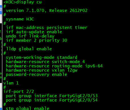

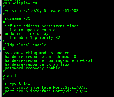

2台68 FortyGigE1/0/53 跟54 做堆叠,版本一致,堆叠报错:
Jan 2 04:20:31:256 2011 H3C DRVPLAT/4/DrvDebug: The port Forty1/0/53 can't receive irf pkt, please check. %Jan 2 04:20:40:374 2011 H3C DRVPLAT/4/DrvDebug: The port Forty1/0/53 can't receive irf pkt, please check. %Jan 2 04:20:49:448 2011 H3C DRVPLAT/4/DrvDebug: The port Forty1/0/53 can't receive irf pkt, please check. %Jan 2 04:20:58:545 2011 H3C DRVPLAT/4/DrvDebug: The port Forty1/0/53 can't receive irf pkt, please check. %Jan 2 04:21:07:639 2011 H3C DRVPLAT/4/DrvDebug: The port Forty1/0/53 can't receive irf pkt, please check.
主配置:
备配置:
硬件资源不一致 switch-mode 0 和4 需要调整到一致

回复61990:
More4改为mode0试试行不行

回复61990:
More4改为mode0试试行不行
