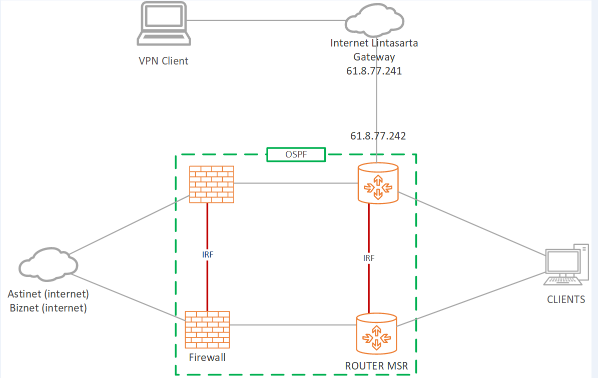

参考案例https://zhiliao.h3c.com/Theme/details/71091
配置之后,设备报错如下:
%Mar 27 22:50:11:611 2021 BNC-JKT-MSR IKE/6/IKE_P1_SA_ESTABLISH_FAIL: Failed to establish phase 1 in Main mode IKE_P1_STATE_INIT state. Reason: Unsupported DH group: 19.. Attribute GROUP_DESCRIPTION.. SA information: Role: responder Local IP: 61.8.77.242 Local ID type: Unknown Local ID: Local port: 500 Retransmissions: 0 Remote IP: 110.138.94.6 Remote ID type: Unknown Remote ID: Remote port: 1525 Recived retransmissions: 0 Inside VPN instance: Outside VPN instance: Initiator COOKIE: 62c951eecfc3438e Responder COOKIE: 3d5bc33878a75b83 Connection ID: 69 Tunnel ID: 4294967295 IKE profile name:
请问是什么原因
粉丝:9人 关注:1人
看提示Unsupported DH group是DH组配错了吧,IKE第一阶段都没有起来,检查两端配置吧
粉丝:8人 关注:2人
第一阶段没起来
