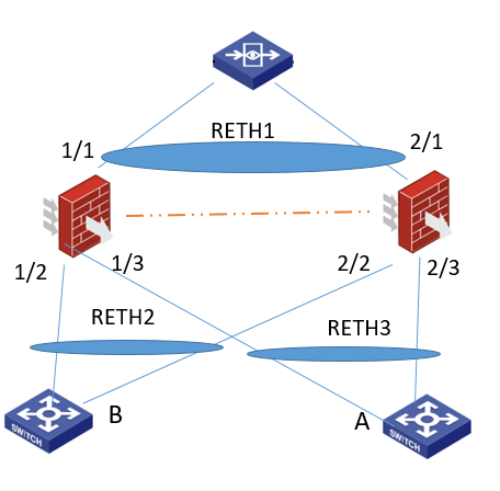

Track联动结果会引起节点内所有的口down,例如【图一】实验中1/1的对端交换机的口shutdown,此时:
GigabitEthernet1/0/1
Current state: DOWN
Line protocol state: DOWN
GigabitEthernet1/0/2
Current state: ETH-rddc Shutdown
Description: GigabitEthernet1/0/2 Interface
所以现场的情况是正常的,目前设备的实现机制如此。
