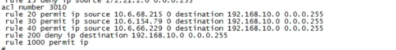

Warning: Classifier-behavior c3010 in policy p3010 applied on interface GigabitEthernet3/0/32 failed in slot 3. Reason: Not supported by hardware.(qos流策略接口报错)
Error: Slot=3 Fail to apply or refresh packet filter policy 3010 rule 10 on interface GigabitEthernet3/0/32.Not supported.
(包过滤接口报错)

svi接口下面调用outbound 方向也不行

这个是单独的qos行为,没有跟其他的冲突,而且要调用的物理接口上目前没有任何策略使用
