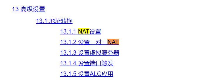

您好,参考ERG2-450W配置手册
https://www.h3c.com/cn/d_202103/1390792_30005_0.htm
