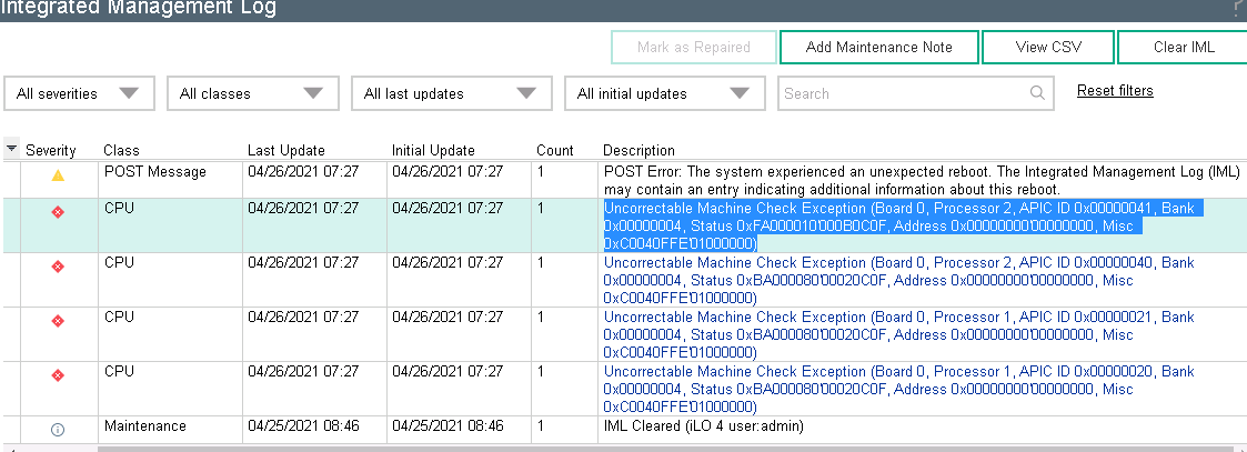

hp  DL385p Gen8 重启,bmc看到有cpu报错,求大神帮忙看下

触发了CPU的MCA/MCE告警,请联系400处理。
需要提供日志分析,判断是CPU内部还是外部引起的,是否是可纠正的错误。然后更换外部设备或CPU。
参考:
https://techlibrary.hpe.com/docs/iss/shared/troubleshoot_gen10/GUID-0283D1C0-09B5-4698-86D6-F600713C2C49.html
  1. Review the error message text for additional details to troubleshoot the specified components.
    1. If the message text directs you to replace an AMD processor, try reseating the processor before replacing the processor.
      Be sure to review the processor information in the maintenance and service guide before servicing the processor.
    2. If the issue still exists, continue to the next step.
  2. Download the Active Health System log and the OS logs.
  3. Update the system firmware.
    Do not attempt to update the firmware more than one time. If the issue still exists after updating the firmware, continue to the next step.
  4. If the issue persists, open a support case using the Hewlett Packard Enterprise Support Center website (https://www.hpe.com/support/hpesc).
    For more information, see Opening a support case.
您好,对于这种相关的报错,可能是BIOS配置引起的问题
重启应该就可以恢复,应该是BIOS开启了省电模式
