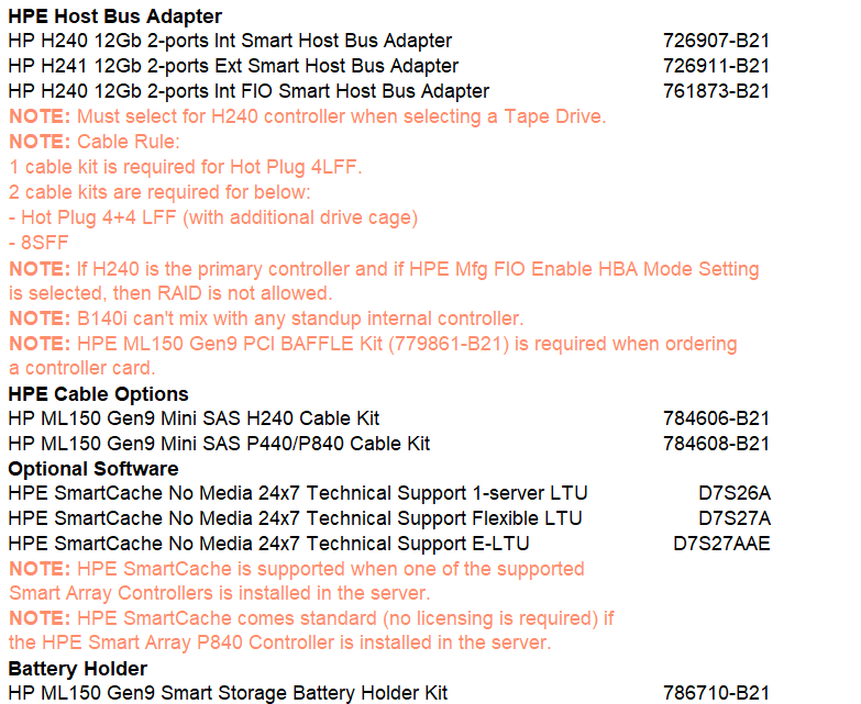

ML150 Gen9 如何支持sas硬盘?自带的B140无法支持sas硬盘

ML150 Gen9 如何支持sas硬盘?自带的B140无法支持sas硬盘 ?

可以添加sas阵列卡

您好 想问问 添加那个型号的卡?
zhiliao_EUa7GN 发表时间:2021-05-07
SAS Controllers HPE Smart Array Controllers HP Smart Array P440/2GB FBWC 12Gb 1-port Int SAS Controller 820834-B21 HP Smart Array P440/4GB FBWC 12Gb 1-port Int SAS Controller 726821-B21 HP Smart Array P441/4GB FBWC 12Gb 2-ports Ext SAS Controller 726825-B21 HP Smart Array P840/4GB FBWC 12Gb 2-ports Int SAS Controller NOTE: 16SFF is limited to P840. 726897-B21 HP Smart Array P841/4GB FBWC 12Gb 4-ports Ext SAS Controller 726903-B21 HP Smart Array P440/4GB FBWC 12Gb 1-port Int FIO SAS Controller NOTE: Smart Storage Battery included. NOTE:?Must select battery holder P/N: 786710-B21 when?purchasing the?P440. NOTE: B140i can't mix with any standup internal controller. NOTE: HPE ML150 Gen9 Mini SAS P440/P840 Cable Kit must be selected P/N: 784606-B21 for P440 controller (1 cable kit is required for P440x1). NOTE: HPE ML150 Gen9 PCI BAFFLE Kit (779861-B21) is required when?ordering the?H240 controller card. 761872-B21 HP Smart Array P840/4GB FBWC 12Gb 2-ports Int FIO SAS Controller NOTE: Smart Storage Battery included. NOTE:?B140i can't mix with any standup internal controller. NOTE: Must select the?P840/4G FIO Controller when an additional drive cage is selected.? NOTE: Must select P840/4G Controller when apply 16SFF. NOTE:?Must select battery holder when?purchase P440 P/N: 786710-B21. NOTE: HPE ML150 Gen9Mini SAS P440/P840 Cable Kit must be selected P/N: 784606-B21 for P840 controller (2 cable kits are required for P840x1). NOTE:?HPE ML150 Gen9 PCI BAFFLE Kit (779861-B21) is required when ordering?a?controller card. 761874-B21 SAS Controller Options HP 96W Smart Storage Battery with 145mm Cable for DL/ML/SL Servers 727258-B21 HPE Host Bus Adapter HP H240 12Gb 2-ports Int Smart Host Bus Adapter 726907-B21 HP H241 12Gb 2-ports Ext Smart Host Bus Adapter 726911-B21 HP H240 12Gb 2-ports Int FIO Smart Host Bus Adapter NOTE: Must select for H240 controller when selecting a?Tape Drive. NOTE: Cable Rule: 1 cable kit is required for Hot Plug 4LFF. 2 cable kits are required for below: - Hot Plug 4+4 LFF (with additional drive cage) - 8SFF 761873-B21 NOTE: If H240 is the primary controller and if HPE Mfg FIO Enable HBA Mode Setting is selected, then RAID is not allowed. NOTE: B140i can't mix with any standup internal controller. NOTE: HPE ML150 Gen9 PCI BAFFLE Kit (779861-B21)?is required when ordering a?controller card. HPE Cable Options HP ML150 Gen9 Mini SAS H240 Cable Kit 784606-B21 HP ML150 Gen9 Mini SAS P440/P840 Cable Kit 784608-B21

外部存储的方式
如果不想用iscis这种方式, 建议咨询下400,看下产品特性,
叫我靓仔 发表时间:2021-05-07 更多>>
无法内部插raid卡来实现 识别sas硬盘吗?

可以添加支持SAS的阵列卡或使用外置存储
下图为ML150 Gen9服务器支持的阵列卡/HBA卡选件
