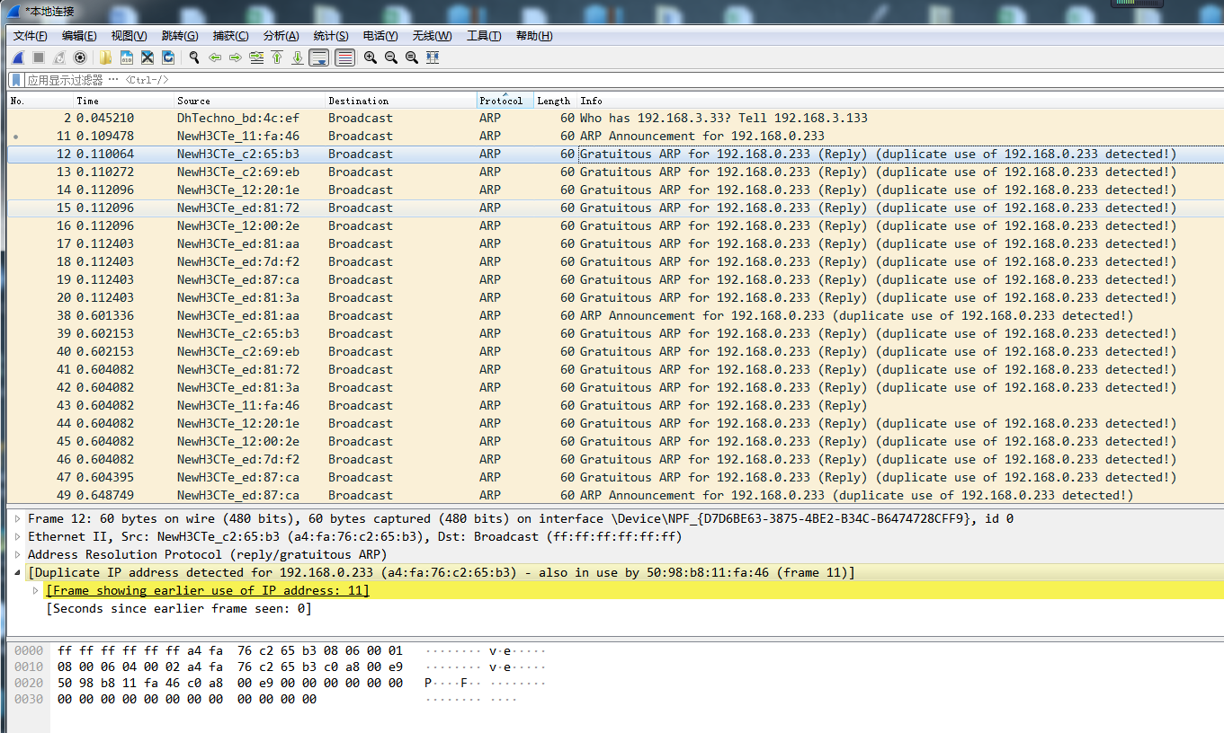

用wireshark抓包分析内网,显示大量ip冲突的arp广播
截取几个详情:
[Duplicate IP address detected for 192.168.0.233 (94:29:2f:ed:87:ca) - also in use by 50:98:b8:11:fa:46 (frame 11)] [Frame showing earlier use of IP address: 11] [Seconds since earlier frame seen: 0]
[Duplicate IP address detected for 192.168.0.233 (94:29:2f:ed:81:3a) - also in use by 50:98:b8:11:fa:46 (frame 11)] [Frame showing earlier use of IP address: 11] [Seconds since earlier frame seen: 1]
[Duplicate IP address detected for 192.168.0.233 (50:98:b8:12:20:1e) - also in use by 50:98:b8:11:fa:46 (frame 43)] [Frame showing earlier use of IP address: 43] [Seconds since earlier frame seen: 0]
然后再次抓包:
[Duplicate IP address detected for 192.168.0.233 (94:29:2f:ed:81:3a) - also in use by a4:fa:76:c2:65:b3 (frame 388)] [Frame showing earlier use of IP address: 388] [Seconds since earlier frame seen: 0]
 [Duplicate IP address detected for 192.168.0.233 (94:29:2f:ed:81:72) - also in use by a4:fa:76:c2:65:b3 (frame 388)] [Frame showing earlier use of IP address: 388] [Seconds since earlier frame seen: 0]
[Duplicate IP address detected for 192.168.0.233 (50:98:b8:12:20:1e) - also in use by a4:fa:76:c2:65:b3 (frame 388)] [Frame showing earlier use of IP address: 388] [Seconds since earlier frame seen: 0]
 请问:是病毒引起的吗?内网也没有0网段的网络啊,只有1、2、3网段的
从反馈的情况来看,以下是排查要点,请参考:
1、看到有IP地址冲突,根据MAC地址找到相应的设备或终端修改掉IP地址。
2、如果确认IP地址没有冲突,可能存在ARP攻击,可先配置ACL拦截这个IP或MAC,然后找到相应的主机后再干掉。

大哥 你这个 明显是管理设备的默认管理地址都是192.168.0.233  造成冲突了   所以设备一直在提示你地址冲突  你登录到设备上把vlan1 的ip地址删了就可以了
管理设备?是指路由器吗?
zhong 发表时间:2021-05-11 更多>>
管理设备?是指路由器吗?
你去找下这个地址冲突了,干掉
或者直接shutdown接口
zhong 一段
知道了,根据mac地址查到都是H3C的交换产品,所以是多个交换机管理ip冲突,晕
