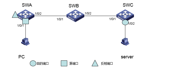

1.2配置需求及实现的效果
在一个二层网络中,SWA通过端口GigabitEthernet1/0/1连接PC,SWC通过端口GigabitEthernet1/0/2连接server。通过配置二层远程端口镜像,使Server可以监控所有进、出PC的报文。
2 组网图
3 配置步骤
配置SWC
# 配置端口GigabitEthernet1/0/1为Trunk口,并允许VLAN 2的报文通过。
<SWC> system-view
[SWC] interface gigabitethernet 1/0/1
[SWC-GigabitEthernet1/0/1] port link-type trunk
[SWC-GigabitEthernet1/0/1] port trunk permit vlan 2
[SWC-GigabitEthernet1/0/1] quit
# 创建远程目的镜像组2。
[SWC] mirroring-group 2 remote-destination
# 创建VLAN 2作为远程镜像VLAN。
[SWC] vlan 2
# 关闭VLAN 2的MAC地址学习功能。
[SWC-vlan2] undo mac-address mac-learning enable
[SWC-vlan2] quit
# 配置远程目的镜像组2的远程镜像VLAN为VLAN 2,目的端口为GigabitEthernet1/0/2,在该端口上关闭生成树协议并将其加入VLAN 2。
[SWC] mirroring-group 2 remote-probe vlan 2
[SWC] interface gigabitethernet 1/0/2
[SWC-GigabitEthernet1/0/2] mirroring-group 2 monitor-port
[SWC-GigabitEthernet1/0/2] undo stp enable
[SWC-GigabitEthernet1/0/2] port access vlan 2
[SWC-GigabitEthernet1/0/2] quit
(2)     配置SWB
<SWB> system-view
[SWB] vlan 2
[SWB-vlan2] undo mac-address mac-learning enable
[SWB-vlan2] quit
[SWB] interface gigabitethernet 1/0/1
[SWB-GigabitEthernet1/0/1] port link-type trunk
[SWB-GigabitEthernet1/0/1] port trunk permit vlan 2
[SWB-GigabitEthernet1/0/1] quit
# 配置端口GigabitEthernet1/0/2为Trunk口,并允许VLAN 2的报文通过。
[SWB] interface gigabitethernet 1/0/2
[SWB-GigabitEthernet1/0/2] port link-type trunk
[SWB-GigabitEthernet1/0/2] port trunk permit vlan 2
[SWB-GigabitEthernet1/0/2] quit
(3)     配置SWA
# 创建远程源镜像组1。
<SWA> system-view
[SWA] mirroring-group 1 remote-source
[SWA] vlan 2
[SWA-vlan2] undo mac-address mac-learning enable
[SWA-vlan2] quit
# 配置远程源镜像组1的远程镜像VLAN为VLAN 2,源端口为GigabitEthernet1/0/1,反射端口为GigabitEthernet1/0/3。
[SWA] mirroring-group 1 remote-probe vlan 2
[SWA] mirroring-group 1 mirroring-port gigabitethernet 1/0/1 both
[SWA] mirroring-group 1 reflector-port gigabitethernet 1/0/3
This operation may delete all settings made on the interface. Continue? [Y/N]: y
[SWA] interface gigabitethernet 1/0/2
[SWA-GigabitEthernet1/0/2] port link-type trunk
[SWA-GigabitEthernet1/0/2] port trunk permit vlan 2
[SWA-GigabitEthernet1/0/2] quit
