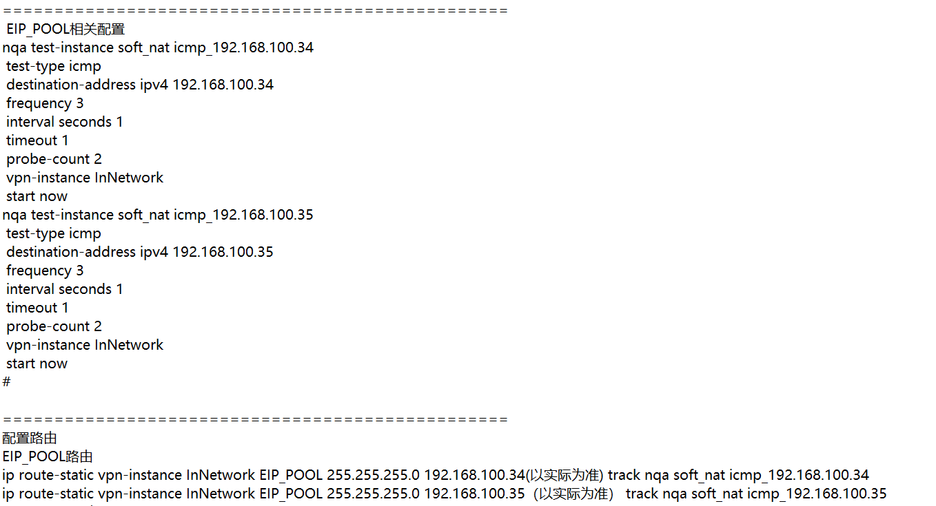

华为配置 华三如何去配?
2021-05-14提问
  • 1收藏,2019浏览
华为配置
这个想表达什么?  EIP_pool 没有这个命令
换到华三的交换机该如何去配置
以下是NQA的参考配置命令:
[SW2]nqa agent enable
[SW2]nqa entry weijianing ninglihua
[SW2-nqa-weijianing-ninglihua]type icmp-echo
[SW2-nqa-weijianing-ninglihua-icmp-echo]source int GigabitEthernet 1/0/1
[SW2-nqa-weijianing-ninglihua-icmp-echo]destination ip 10.0.0.2
[SW2-nqa-weijianing-ninglihua-icmp-echo]frequency 100000
[SW2-nqa-weijianing-ninglihua-icmp-echo]probe timeout 30
[SW2-nqa-weijianing-ninglihua-icmp-echo]next-hop 10.0.0.2
[SW2-nqa-weijianing-ninglihua-icmp-echo] history-record enable
[SW2-nqa-weijianing-ninglihua-icmp-echo]history-record number 50
[SW2-nqa-weijianing-ninglihua-icmp-echo]probe count 10
[SW2-nqa-weijianing-ninglihua-icmp-echo]reaction 1 checked-element probe-fail threshold-type consecutive 1 action-type trigger-only
[SW2-nqa-weijianing-ninglihua-icmp-echo]route-option bypass-route
[SW2]track 1 nqa entry weijianing ninglihua reaction 1
[SW2]nqa schedule weijianing ninglihua start-time now lifetime forever
调用track的话参考命令如下:
ip route-static 0.0.0.0 0.0.0.0 10.1.1.1 track 1
能不能把地址换成我问的地址 更容易理解
