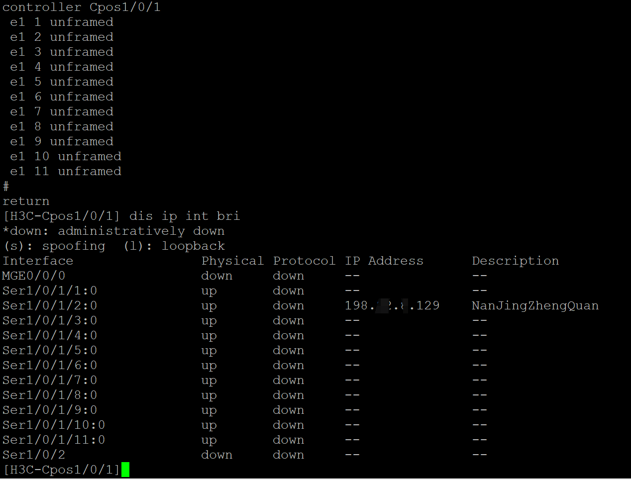

原设备是Cisco的,现在打算替换成华三设备,对于cpos接口该怎么配置呀? 怎么区分时隙呀? 华三打不出Serial9/0/0.1/1/1/1:0这种接口呀。我下面的配置是在模拟器上做的,不知道对不对。麻烦大家帮忙看下。

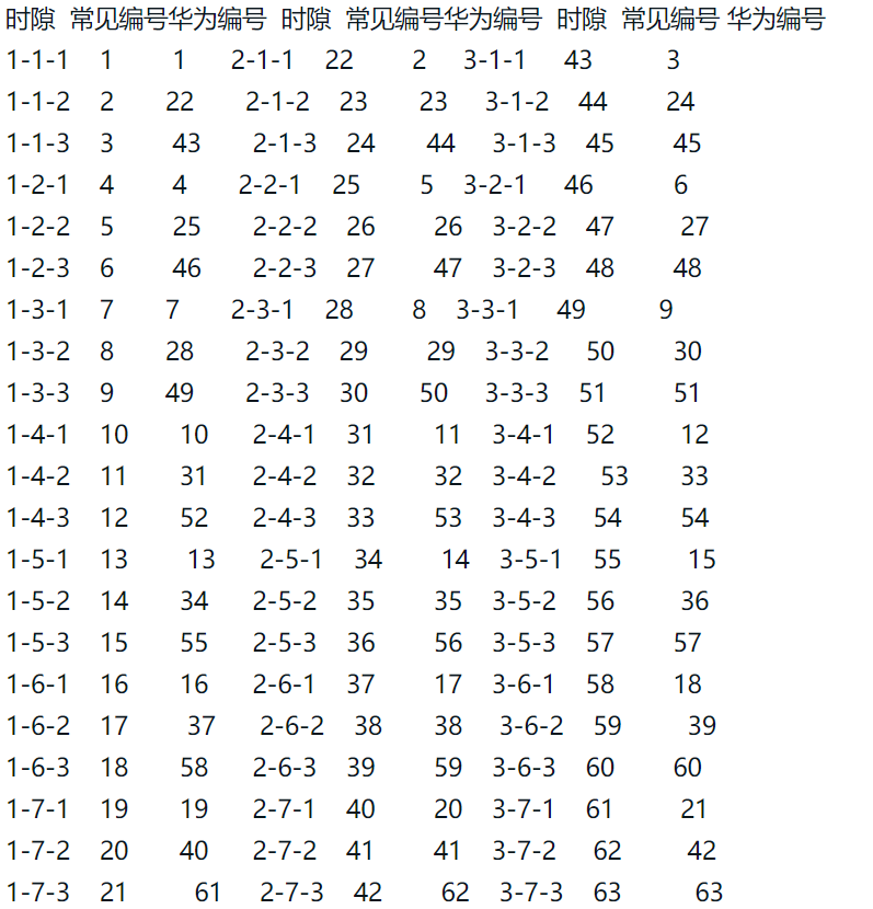

传输时隙计算公式:
常见的时隙顺序计算公式为:VC12序号=(TUG3编号-1)*21+(TUG2编号-1)*3+TU12编号
华为的时隙顺序计算公式为:VC12序号=TUG3编号+(TUG2编号-1)*3+(TU12编号-1)*21
对照表
时隙  常见编号华为编号  时隙  常见编号华为编号  时隙  常见编号 华为编号
1-1-1    1        1      2-1-1    22        2     3-1-1     43          3
1-1-2    2       22       2-1-2    23       23     3-1-2    44        24
1-1-3    3        43       2-1-3    24       44     3-1-3    45        45
1-2-1    4        4       2-2-1    25        5    3-2-1     46           6
1-2-2    5        25       2-2-2    26        26    3-2-2    47         27
1-2-3    6        46       2-2-3    27        47    3-2-3    48        48
1-3-1    7       7       2-3-1    28        8    3-3-1     49          9
1-3-2    8       28       2-3-2    29        29    3-3-2     50        30
1-3-3    9       49       2-3-3    30       50     3-3-3    51         51
1-4-1    10       10      2-4-1    31        11    3-4-1    52         12
1-4-2    11       31      2-4-2    32        32    3-4-2      53       33
1-4-3    12       52      2-4-3    33        53    3-4-3     54        54
1-5-1    13        13      2-5-1    34        14    3-5-1    55         15
1-5-2    14       34      2-5-2    35        35    3-5-2    56         36
1-5-3    15       55      2-5-3    36        56    3-5-3    57        57
1-6-1    16       16      2-6-1    37        17    3-6-1    58        18
1-6-2    17        37      2-6-2    38       38     3-6-2    59         39
1-6-3    18       58      2-6-3    39        59    3-6-3    60        60
1-7-1    19       19      2-7-1    40        20    3-7-1    61         21
1-7-2    20       40      2-7-2    41        41    3-7-2     62         42
1-7-3    21         61     2-7-3    42        62    3-7-3    63          63

这个我之前看过;我想问下华三怎么按时隙区分不同接口来配置IP呀
zhiliao_qQkXJN 发表时间:2021-05-18 更多>>
H3C侧配置的参考命令如下:
controller Cpos8/3/1
e1 1 unframed
e1 2 unframed
e1 3 unframed
e1 4 unframed
e1 5 unframed
e1 6 unframed
e1 7 unframed
e1 8 unframed
e1 9 unframed
e1 10 unframed
e1 11 unframed
e1 12 unframed
e1 13 unframed
e1 14 unframed
e1 15 unframed
e1 16 unframed
e1 17 unframed
e1 18 unframed
e1 19 unframed
e1 20 unframed
e1 21 unframed
e1 22 unframed
e1 23 unframed
e1 24 unframed
e1 25 unframed
e1 26 unframed
e1 27 unframed
e1 28 unframed
e1 29 unframed
e1 30 unframed
e1 31 unframed
e1 32 unframed
e1 33 unframed
e1 34 unframed
e1 35 unframed
e1 36 unframed
e1 37 unframed
e1 38 unframed
e1 39 unframed
e1 40 unframed
e1 41 unframed
e1 42 unframed
e1 43 unframed
e1 44 unframed
e1 45 unframed
e1 46 unframed
e1 47 unframed
e1 48 unframed
e1 49 unframed
e1 50 unframed
e1 51 unframed
e1 52 unframed
e1 53 unframed
e1 54 unframed
e1 55 unframed
e1 56 unframed
e1 57 unframed
e1 58 unframed
e1 59 unframed
e1 60 unframed
e1 61 unframed
e1 62 unframed
e1 63 unframed
interface Serial8/3/1/1:0
description To G123
link-protocol ppp
mtu 1526
ip address 10.0.0.1 255.255.255.252
ospf network-type p2p
ospf bfd enable
mpls
mpls ldp
