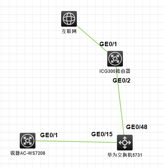

详细配置如下:
一、AC配置
ip http port 80
ip http secure-port 4430
enable service web-server all
enable service web-server http
enable service web-server https
interface GigabitEthernet 0/1
 no switchport
 no ip unreachables
 no ip redirects
 no ip mask-reply
ip address 192.168.200.2 255.255.255.0
ip route 172.16.1.0 255.255.255.0 192.168.200.1
ip route 172.230.0.0 255.255.0.0 192.168.200.1
二、交换机配置如下:
vlan batch 10 100 200
 interface Vlanif100
 ip address 172.16.1.2 255.255.255.0
 interface Vlanif200
 ip address 192.168.200.1 255.255.255.0
 interface GigabitEthernet0/0/15
 port default vlan 200
 interface GigabitEthernet0/0/48
 port default vlan 100
 ip route-static 0.0.0.0 0.0.0.0 172.16.1.1
三、路由器配置如下
 vlan 1
 interface Vlan-interface1
 ip address 172.16.1.1 255.255.255.0
 interface GigabitEthernet0/1
 port link-mode route
 nat outbound
 nat server 63 protocol tcp global current-interface 2020 inside 192.168.200.2 www
 nat server 64 protocol tcp global current-interface 2021 inside 192.168.200.2 4430
 ip address X.X.X.X 255.255.255.128
 dns server 221.7.34.10
 dns server 221.7.34.11
 interface GigabitEthernet0/2
 port link-mode bridge
ip route-static 0.0.0.0 0.0.0.0 GigabitEthernet0/1 X.X.X.X(公网地址)
ip route-static 192.168.200.0 255.255.255.0 172.16.1.2

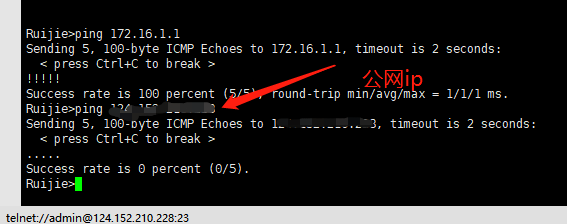

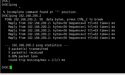

路由器验证结果:

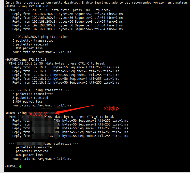

交换机验证结果:
AC验证结果:

路由器验证结果:
交换机验证结果:
AC验证结果:

ac添加默认路由
为什么加默认路由就可以了呢
