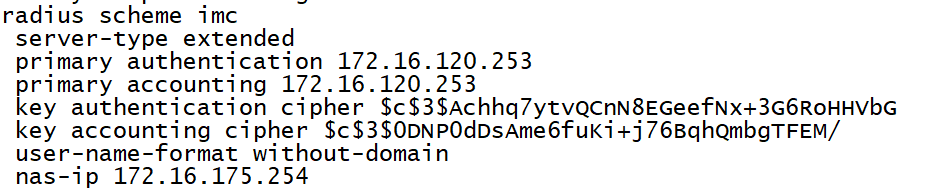

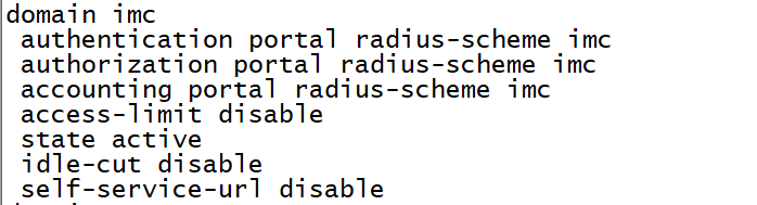

imc登录提示向设备发送请求超时,在IMC侧没有查到用户认证失败的日志
AC是V5的WX6108E,业务网关及地址池也在AC上
interface Vlan-interface160
 description wuxian_yewu
 ip address 172.16.175.254 255.255.240.0
 portal server imc method direct
 portal domain imc portal nas-ip 172.16.175.254
