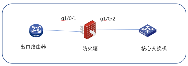

防火墙透明部署非常简单
1、把物理口配置成二层口
2、配置一个BVI接口,二层口都加入这个BVI
3、不同的二层口加入到不同的域
4、配置相应的域间策略即可

这款墙的透明模式,进入接口下直接改成二层模式即可
inter   GigabitEthernet0/1
port link-mode bridge
其它配置,和三层模式配置方法一样,比如将端口加入安全域、域间策略,二层模式和三层模式配置方式和思路都一样的

[H3C]display current-configuration
version 7.1.064, Release 8860P41
sysname H3C
clock protocol none
irf mac-address persistent timer
irf auto-update enable
undo irf link-delay
irf member 1 priority 1
dns server 8.8.8.8
dns server 114.114.114.114
password-recovery enable
vlan 1
vlan 100
interface NULL0
interface Vlan-interface100
ip address 192.168.100.246 255.255.255.0
port link-mode route
interface GigabitEthernet1/0/4
interface GigabitEthernet1/0/5
interface GigabitEthernet1/0/6
interface GigabitEthernet1/0/7
interface GigabitEthernet1/0/9
interface GigabitEthernet1/0/10
interface GigabitEthernet1/0/11
interface GigabitEthernet1/0/0
port access vlan 100
interface GigabitEthernet1/0/8
security-zone name Local
security-zone name Trust
import interface Vlan-interface100
import interface GigabitEthernet1/0/8 vlan 1 to 4094
security-zone name DMZ
security-zone name Untrust
import interface GigabitEthernet1/0/0 vlan 1 to 4094
security-zone name Management
zone-pair security source Local destination Trust
packet-filter 3000
zone-pair security source Local destination Untrust
packet-filter 3000
zone-pair security source Trust destination Local
packet-filter 3000
zone-pair security source Trust destination Untrust
packet-filter 3000
zone-pair security source Untrust destination Local
packet-filter 3000
zone-pair security source Untrust destination Trust
packet-filter 3000
scheduler logfile size 16
line class aux
user-role network-operator
line class console
authentication-mode scheme
user-role network-admin
line class vty
line aux 0
authentication-mode none
line con 0
line vty 0 63
ip route-static 0.0.0.0 0 192.168.100.1
performance-management
ssh server enable
acl advanced 3000
rule 0 permit ip
undo password-control blacklist all-line
domain system
domain default enable system
role name level-0
description Predefined level-0 role
role name level-1
description Predefined level-1 role
role name level-2
description Predefined level-2 role
role name level-3
description Predefined level-3 role
role name level-4
description Predefined level-4 role
role name level-5
description Predefined level-5 role
role name level-6
description Predefined level-6 role
role name level-7
description Predefined level-7 role
role name level-8
description Predefined level-8 role
role name level-9
description Predefined level-9 role
role name level-10
description Predefined level-10 role
role name level-11
description Predefined level-11 role
role name level-12
description Predefined level-12 role
role name level-13
description Predefined level-13 role
role name level-14
description Predefined level-14 role
user-group system
local-user IT class manage
password hash $h$6$ep+a1CetbMFdhvE/$iXiGDUCViiZLNAePaSmarK050bvQPRflFEpB0H1J1BOyGuthHSVdePHdBHKB45C9T4IXOb5ZZTDgQIPK3UTrZw==
service-type ssh telnet termina http https
authorization-attribute user-role level-15
authorization-attribute user-role network-admin
authorization-attribute user-role network-operator
local-user admin class manage
password hash $h$6$QRZpQH7ack5KdbZT$7Cn8guOGEAys4Ibys1S9t4MOCarqZEZM7RzyNkSNTfSrGzbawE/3X3eN2rP5bRG4sRO4Lh+FQJnRTa+aK2BwCQ==
service-type ssh telnet terminal http https
authorization-attribute user-role level-3
ip http enable
ip https enable
loadbalance isp file flash:/lbispinfo_v1.5.tp
security-policy ip
rule 0 name TRUST-UNTRUST
action pass
source-zone Trust
destination-zone Untrust
rule 1 name UNTRUST-TRUST
action pass
source-zone Untrust
destination-zone Trust
rule 2 name TRUST-LOCAL
action pass
source-zone Trust
destination-zone Local
cloud-management server domain opstunnel-seccloud.h3c.com
return
[H3C]
写入配置
[H3C]save force
Validating file. Please wait...
Saved the current configuration to mainboard device successfully.
[H3C]
