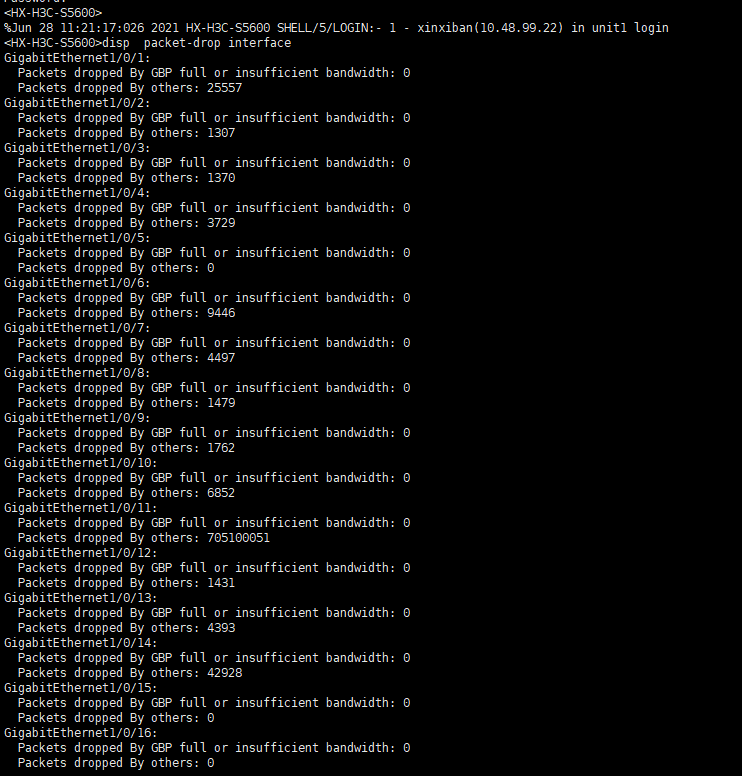

交换机端口11口丢弃报文很多,如何排查?

有持续增长吗?
您好,参考
1、检查物理链路是否有问题
2、检查设备的CPU、内存、端口利用率是否高
3、检查设备内是否有相应的日志反馈

可以在交换机上配置端口镜像,并终端进行抓包看下有哪些数据包经过交换机,并出了交换机有哪些数据包,确认具体丢弃的是什么数据包。
检查端口的利用率是否已被打满,参考命令为dis int gi 1/0/1查看最近300秒的使用率。
这个11口配置没啥问题,不知道丢的那些包
zhiliao_a6OkBM 发表时间:2021-06-28 更多>>
GigabitEthernet1/0/11 current state : UP IP Sending Frames' Format is PKTFMT_ETHNT_2, Hardware address is 000f-e2cc-14fd Description: to SW_ZL_11f Media type is optical fiber, loopback not set Port hardware type is 1000_BASE_SX_SFP 1000Mbps-speed mode, full-duplex mode Link speed type is autonegotiation, link duplex type is autonegotiation Flow-control is not enabled The Maximum Frame Length is 9216 Broadcast MAX-ratio: 100% Unicast MAX-ratio: 100% Multicast MAX-ratio: 100% Allow jumbo frame to pass PVID: 1 Mdi type: auto Port link-type: trunk VLAN passing : 1(default vlan), 17-33, 35, 888, 991, 1030 VLAN permitted: 1(default vlan), 2-4094 Trunk port encapsulation: IEEE 802.1q Last 300 seconds input: 495 packets/sec 178751 bytes/sec Last 300 seconds output: 542 packets/sec 359009 bytes/sec Input(total): 2782179299 packets, 219389512120 bytes 217419 broadcasts, 147395 multicasts, 0 pauses Input(normal): - packets, - bytes - broadcasts, - multicasts, - pauses Input: 0 input errors, 0 runts, 0 giants, - throttles, 0 CRC - frame, - overruns, 0 aborts, - ignored, - parity errors Output(total): 67556143 packets, 40712002221 bytes 32153071 broadcasts, 4841442 multicasts, 0 pauses Output(normal): - packets, - bytes - broadcasts, - multicasts, - pauses Output: 0 output errors, - underruns, - buffer failures 0 aborts, 0 deferred, 0 collisions, 0 late collisions 0 lost carrier, - no carrier
看下接口带宽,直接监控下接口带宽,看下是否利用率太高,另外可以抓包看下是否有攻击
