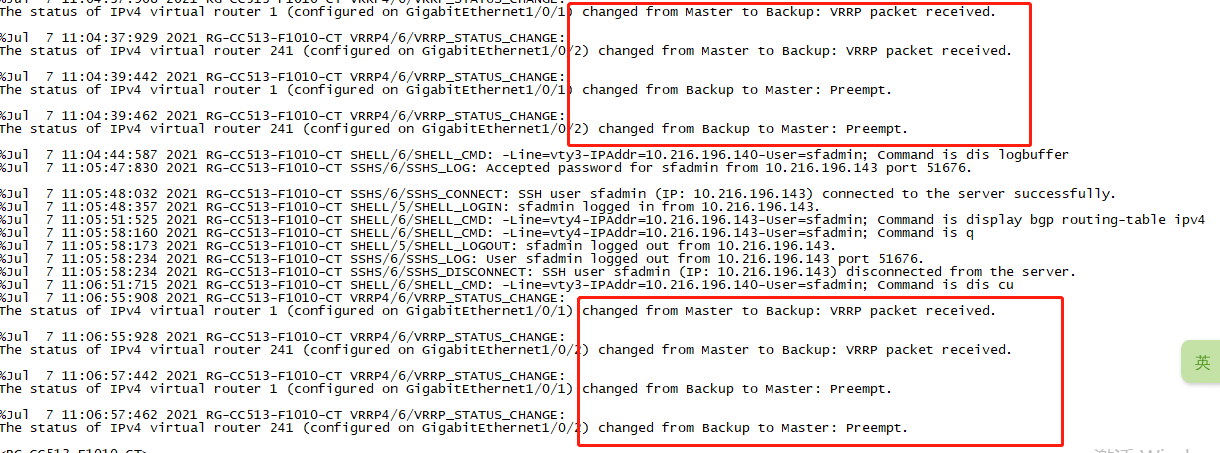

防火墙VRRP主备一直切换
2021-07-07提问
  • 2收藏,2734浏览
防火墙VRRP主备一直切换是什么情况

vrrp配置里面配置vrrp vrid 1 track 1 priority reduced 20,会有影响吗?

Track ID: 1 State: Positive Duration: 0 days 0 hours 10 minutes 37 seconds Notification delay: Positive 0, Negative 0 (in seconds) Tracked object: NQA entry: admin test Reaction: 1 Remote IP/URL: 58.221.184.161 Local IP: -- Interface: GE1/0/0
