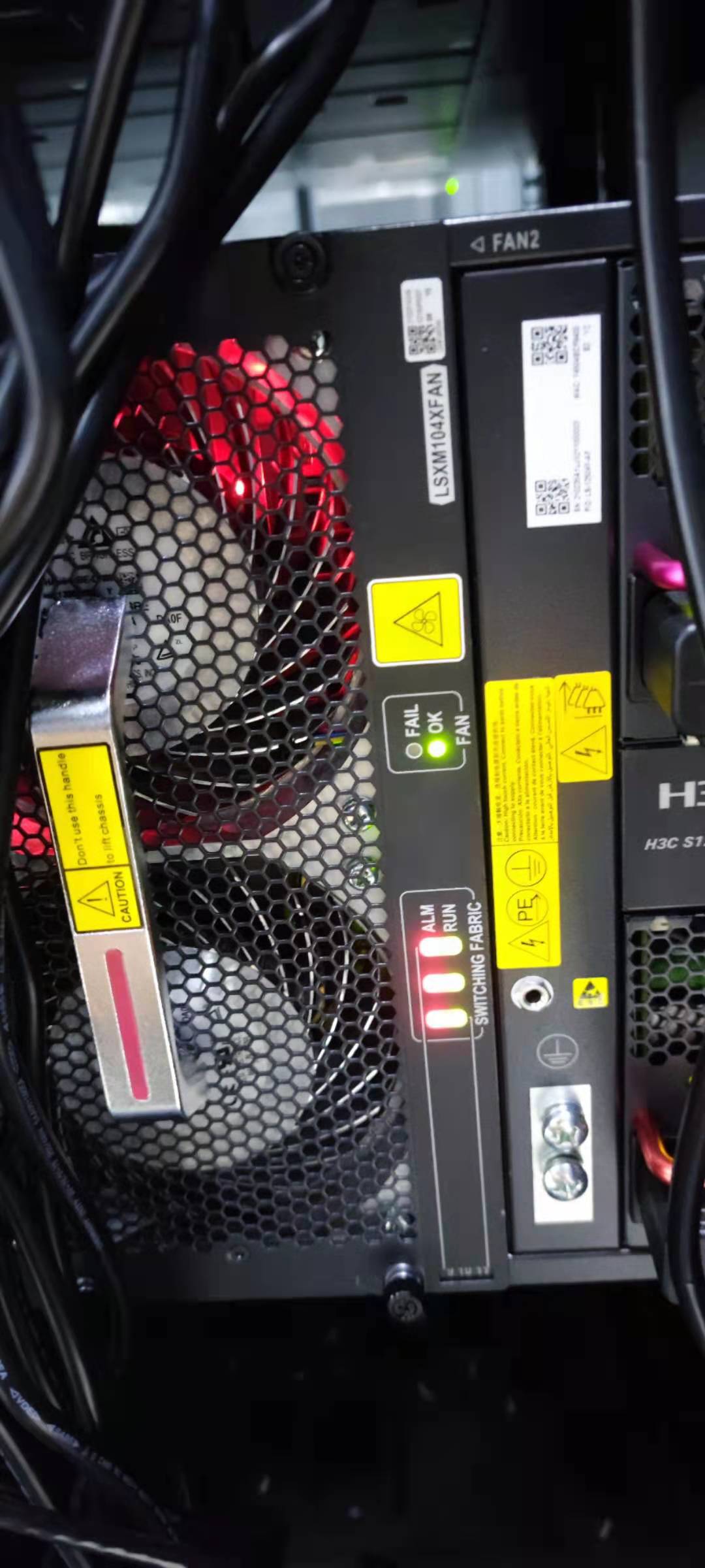

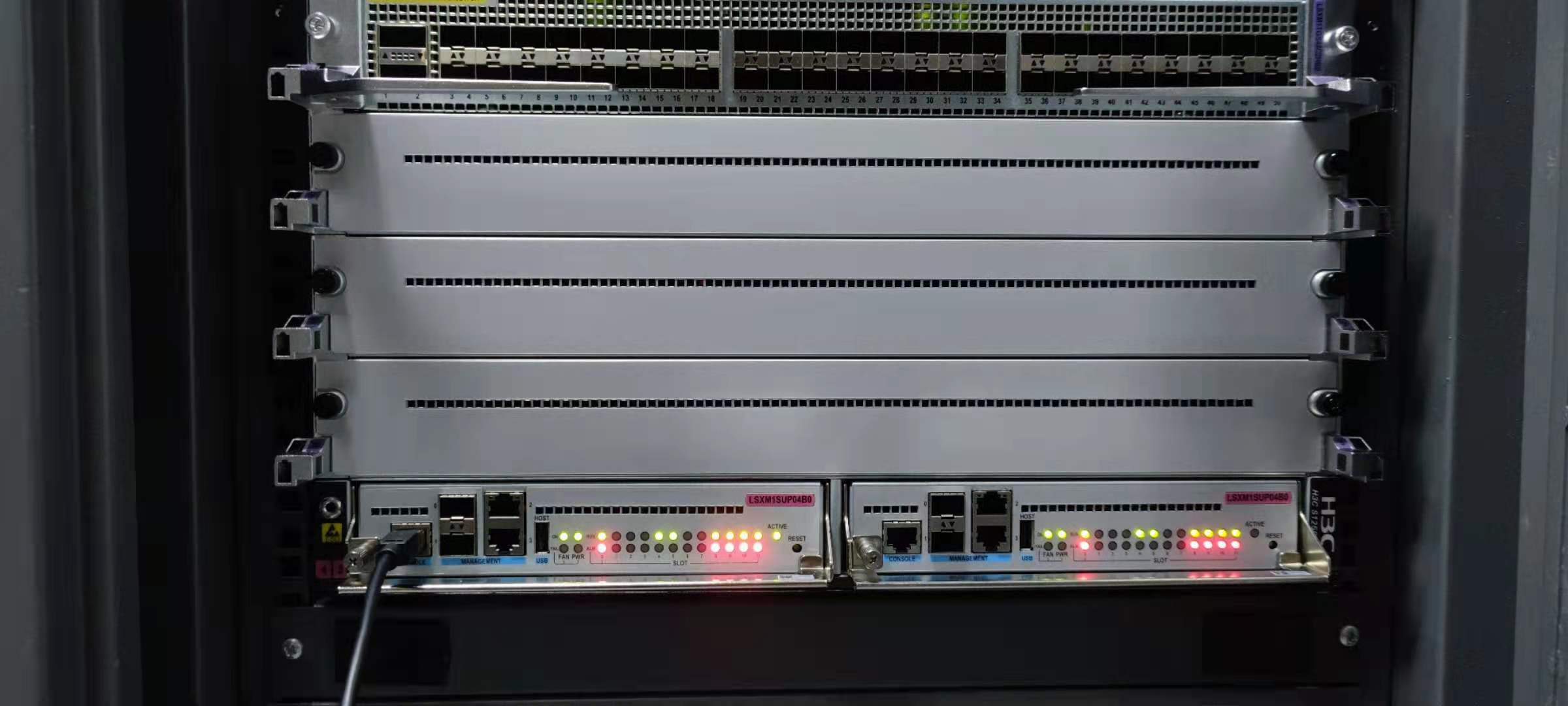

所有slot均为加载上什么原因呢,业务办卡没有加载上,只有主控加载成功了
<H3C>%Jul 13 09:48:22:471 2021 H3C DEV/4/BOARD_LOADING: -MDC=1; Board in slot 0 is loading software images. %Jul 13 09:48:28:352 2021 H3C DEV/4/BOARD_LOADING: -MDC=1; Board in slot 6 is loading software images. %Jul 13 09:48:28:362 2021 H3C DEV/4/BOARD_LOADING: -MDC=1; Board in slot 7 is loading software images. %Jul 13 09:48:28:362 2021 H3C DEV/4/BOARD_LOADING: -MDC=1; Board in slot 9 is loading software images. %Jul 13 09:48:28:375 2021 H3C DEV/4/BOARD_LOADING: -MDC=1; Board in slot 10 is loading software images. <H3C>%Jul 13 09:48:48:217 2021 H3C DEV/5/LOAD_FINISHED: -MDC=1; Board in slot 0 has finished loading software images. %Jul 13 09:48:48:249 2021 H3C DEV/5/LOAD_FINISHED: -MDC=1; Board in slot 7 has finished loading software images. %Jul 13 09:48:48:249 2021 H3C DEV/5/LOAD_FINISHED: -MDC=1; Board in slot 9 has finished loading software images. %Jul 13 09:48:48:272 2021 H3C DEV/5/LOAD_FINISHED: -MDC=1; Board in slot 10 has finished loading software images. %Jul 13 09:48:49:197 2021 H3C DEV/5/LOAD_FINISHED: -MDC=1; Board in slot 6 has finished loading software images.

设备正在开机吧,刚开机先注册主控,然后业务板卡逐个注册
建议升级下版本, 看报错好像是没有业务板的软件包

这种情况持续一晚了,总十加载,但是显示加载完成,总是重复加载
zhiliao_QbPbX 发表时间:2021-07-13
zhiliao_zhui 发表时间:2021-07-13
从反馈的日志来看,设备正在加载板卡,在稍等看下启动情况。
因为是高端产品,启动和加载板卡要点时间,如果是部署了IRF,需要的时间会久一点。
看下125的软件版本是否最新,可考虑升级到最新看下是否还重复加载。
得闲饮茶013 发表时间:2021-07-13 更多>>
您好,这是版本不匹配吧?升级下版本
