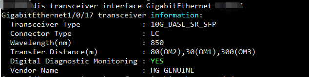

dis transceiver interface + 接口
可以查看到光模块的型号及传输距离

[H3C]display transceiver manuinfo interface //查看光模块生产厂家信息
 [H3C]dis transceiver interface GigabitEthernet 1/0/1 //查看光模块的信息
[H3C]dis transceiver diagnosis interface GigabitEthernet 1/0/1 //查看光口的收发情况
 [H3C]dis transceiver alarm interface GigabitEthernet 1/0/1 //查看光口的告警信息
