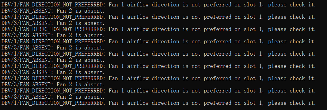

这个报警怎么解决
2021-07-19提问
  • 1收藏,5001浏览
粉丝:1人 关注:11人
这个报警怎么解决

参考这个案例:
display fan 查看风扇转向 出现FanDirectionFault 这就出错了
fan prefer-direction slot 1 port-to-power 这个命令可以改变风扇的方向
如果是交换机的member 号已经改变了,就直接在系统窗口
参数 n是member号,
[H3C]fan prefer-direction slot n port-to-power
  • 1
再次 display fan 查看风扇转向 出现Normal
<H3C>system <H3C>system-view System View: return to User View with Ctrl+Z. [H3C]line aux 0 [H3C-line-aux0]%Jan 1 00:03:11:704 2011 H3C DEV/1/FAN_DIRECTION_NOT_PREFERRED: Fan 1 airflow direction is not preferred on slot 1, please check it. %Jan 1 00:03:11:705 2011 H3C DEV/1/FAN_DIRECTION_NOT_PREFERRED: Fan 2 airflow direction is not preferred on slot 1, please check it. %Jan 1 00:03:11:706 2011 H3C DEV/1/FAN_DIRECTION_NOT_PREFERRED: Fan 3 airflow direction is not preferred on slot 1, please check it. %Jan 1 00:03:11:707 2011 H3C DEV/1/FAN_DIRECTION_NOT_PREFERRED: Fan 4 airflow direction is not preferred on slot 1, please check it. %Jan 1 00:03:11:707 2011 H3C DEV/1/FAN_DIRECTION_NOT_PREFERRED: Fan 5 airflow direction is not preferred on slot 1, please check it. [H3C-line-aux0] [H3C-line-aux0] [H3C-line-aux0]%Jan 1 00:04:31:704 2011 H3C DEV/1/FAN_DIRECTION_NOT_PREFERRED: Fan 1 airflow direction is not preferred on slot 1, please check it. %Jan 1 00:04:31:705 2011 H3C DEV/1/FAN_DIRECTION_NOT_PREFERRED: Fan 2 airflow direction is not preferred on slot 1, please check it. %Jan 1 00:04:31:705 2011 H3C DEV/1/FAN_DIRECTION_NOT_PREFERRED: Fan 3 airflow direction is not preferred on slot 1, please check it. %Jan 1 00:04:31:706 2011 H3C DEV/1/FAN_DIRECTION_NOT_PREFERRED: Fan 4 airflow direction is not preferred on slot 1, please check it. %Jan 1 00:04:31:707 2011 H3C DEV/1/FAN_DIRECTION_NOT_PREFERRED: Fan 5 airflow direction is not preferred on slot 1, please check it. %Jan 1 00:05:51:704 2011 H3C DEV/1/FAN_DIRECTION_NOT_PREFERRED: Fan 1 airflow direction is not preferred on slot 1, please check it. %Jan 1 00:05:51:705 2011 H3C DEV/1/FAN_DIRECTION_NOT_PREFERRED: Fan 2 airflow direction is not preferred on slot 1, please check it. %Jan 1 00:05:51:705 2011 H3C DEV/1/FAN_DIRECTION_NOT_PREFERRED: Fan 3 airflow direction is not preferred on slot 1, please check it. %Jan 1 00:05:51:706 2011 H3C DEV/1/FAN_DIRECTION_NOT_PREFERRED: Fan 4 airflow direction is not preferred on slot 1, please check it. %Jan 1 00:05:51:707 2011 H3C DEV/1/FAN_DIRECTION_NOT_PREFERRED: Fan 5 airflow direction is not preferred on slot 1, please check it. [H3C-line-aux0] [H3C-line-aux0] [H3C-line-aux0]display fan Slot 1: Fan 1: State : FanDirectionFault Airflow Direction: Port-to-power Prefer Airflow Direction: Power-to-port Fan 2: State : FanDirectionFault Airflow Direction: Port-to-power Prefer Airflow Direction: Power-to-port Fan 3: State : FanDirectionFault Airflow Direction: Port-to-power Prefer Airflow Direction: Power-to-port Fan 4: State : FanDirectionFault Airflow Direction: Port-to-power Prefer Airflow Direction: Power-to-port Fan 5: State : FanDirectionFault Airflow Direction: Port-to-power Prefer Airflow Direction: Power-to-port ---- More ----%Jan 1 00:07:11:704 2011 H3C DEV/1/FAN_DIRECTION_NOT_PREFERRED: Fan 1 airflow direction is not preferred on slot 1, please check it. %Jan 1 00:07:11:705 2011 H3C DEV/1/FAN_DIRECTION_NOT_PREFERRED: Fan 2 airflow direction is not preferred on slot 1, please check it. %Jan 1 00:07:11:705 2011 H3C DEV/1/FAN_DIRECTION_NOT_PREFERRED: Fan 3 airflow direction is not preferred on slot 1, please check it. %Jan 1 00:07:11:706 2011 H3C DEV/1/FAN_DIRECTION_NOT_PREFERRED: Fan 4 airflow direction is not preferred on slot 1, please check it. %Jan 1 00:07:11:707 2011 H3C DEV/1/FAN_DIRECTION_NOT_PREFERRED: Fan 5 airflow direction is not preferred on slot 1, please check it. %Jan 1 00:08:31:704 2011 H3C DEV/1/FAN_DIRECTION_NOT_PREFERRED: Fan 1 airflow direction is not preferred on slot 1, please check it. %Jan 1 00:08:31:705 2011 H3C DEV/1/FAN_DIRECTION_NOT_PREFERRED: Fan 2 airflow direction is not preferred on slot 1, please check it. %Jan 1 00:08:31:705 2011 H3C DEV/1/FAN_DIRECTION_NOT_PREFERRED: Fan 3 airflow direction is not preferred on slot 1, please check it. %Jan 1 00:08:31:706 2011 H3C DEV/1/FAN_DIRECTION_NOT_PREFERRED: Fan 4 airflow direction is not preferred on slot 1, please check it. %Jan 1 00:08:31:707 2011 H3C DEV/1/FAN_DIRECTION_NOT_PREFERRED: Fan 5 airflow direction is not preferred on slot 1, please check it. [H3C-line-aux0]fan prefer-direction slot 1 port-to-power [H3C]%Jan 1 00:09:38:104 2011 H3C DEV/5/FAN_RECOVERED: Fan 1 recovered. %Jan 1 00:09:38:105 2011 H3C DEV/5/FAN_RECOVERED: Fan 2 recovered. %Jan 1 00:09:38:106 2011 H3C DEV/5/FAN_RECOVERED: Fan 3 recovered. %Jan 1 00:09:38:107 2011 H3C DEV/5/FAN_RECOVERED: Fan 4 recovered. %Jan 1 00:09:38:109 2011 H3C DEV/5/FAN_RECOVERED: Fan 5 recovered. [H3C]dis fan Slot 1: Fan 1: State : Normal Airflow Direction: Port-to-power Prefer Airflow Direction: Port-to-power Fan 2: State : Normal Airflow Direction: Port-to-power Prefer Airflow Direction: Port-to-power Fan 3: State : Normal Airflow Direction: Port-to-power Prefer Airflow Direction: Port-to-power Fan 4: State : Normal Airflow Direction: Port-to-power Prefer Airflow Direction: Port-to-power Fan 5: State : Normal Airflow Direction: Port-to-power Prefer Airflow Direction: Port-to-power

display fan看下风扇是否都在位
检查下风扇的进出风的风向是否跟系统一致
dis fan检查风扇的状态是否正常,如果是absent,检查风扇模块是否安装到位,如果是fault,风扇模块故障了

收集display fan,先查看风扇是什么状态的。
  ===============display fan===============
 Slot 1:
Fan 1:
 State    : Normal
Fan 2:
 State    : Normal
如果风扇的Airflow Direction与Prefer Airflow Direction不一致,那么就需要调整设备的Prefer Airflow Direction,调整到一致的状态就不会再有告警。
fan prefer-direction slot 1 power-to-port
fan prefer-direction slot 2 power-to-port
