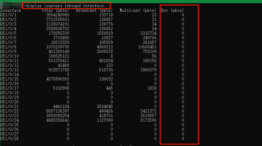

交换机接口入流量换算
2021-07-29提问
  • 1收藏,7783浏览
上面入接口流量的值是以pkts为单位的,可以换算成其他单位么,怎么换算成实时带宽

dis interface Ten-GigabitEthernet1/0/1 可以看到
Current state: UP
Line protocol state: UP
Description: Ten-GigabitEthernet1/0/1 Interface
Bandwidth: 10000000 kbps
Maximum transmission unit: 1500
Allow jumbo frames to pass
Broadcast max-ratio: 100%
Unknown-multicast max-ratio: 100%
Unicast max-ratio: 100%
Internet protocol processing: Disabled
IP packet frame type: Ethernet II, hardware address: 74ea-c830-5112
IPv6 packet frame type: Ethernet II, hardware address: 74ea-c830-5112
Media type is stack wire, port hardware type is STACK_SFP_PLUS
Ethernet port mode: LAN
Port priority: 0
10Gbps-speed mode, full-duplex mode
Link speed type is autonegotiation, link duplex type is autonegotiation
Flow-control is not enabled
The maximum frame length is 12288
Last link flapping: 16 hours 16 minutes 49 seconds
Last clearing of counters: Never
Peak input rate: 15 bytes/sec, at 2021-11-23 23:52:30
Peak output rate: 21 bytes/sec, at 2021-11-23 23:52:30
Last 300 second input: 0 packets/sec 11 bytes/sec 0%
Last 300 second output: 0 packets/sec 16 bytes/sec 0%
Input (total): 5850 packets, 1953227 bytes
145 unicasts, 6 broadcasts, 5699 multicasts, 0 pauses
Input (normal): 5850 packets, - bytes
Input: 0 input errors, 0 runts, 0 giants, 0 throttles
0 CRC, 0 frame, - overruns, 0 aborts
- ignored, - parity errors
Output (total): 11555 packets, 2666782 bytes
145 unicasts, 6 broadcasts, 11404 multicasts, 0 pauses
Output (normal): 11555 packets, - bytes
Output: 0 output errors, - underruns, 0 buffer failures
0 aborts, 0 deferred, 0 collisions, 0 late collisions
0 lost carrier, - no carrier
您好,参考
如果一个packet封装了10个字节,那么1Kpkts就等效于10Kbps(字节/秒)
一兆字节(1MB)就等于1024千字节(1024KB),就等1024乘以1024字节(1024*1024B)
1G bit= 1,000M bit= 1,000,000K bit= 1,000,000,000 bit
MB和bit 单位换算:1MB=8388608 bit
粉丝:42人 关注:7人
就例如上面展示的值呢怎么换算
zhiliao_cKizhh 发表时间:2021-07-29 更多>>
就例如上面展示的值呢怎么换算
