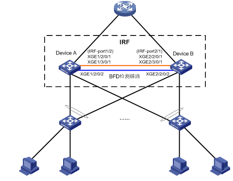

如图1-14所示,配置Device A和Device B组成IRF设备,接入层设备通过聚合双链路上行。因为成员设备比较少,我们配置BFD MAD进行分裂检测。
2. 组网图
图1-14 IRF典型配置组网图(BFD MAD检测方式)
3. 配置步骤

(3)       配置BFD MAD检测
# 创建三层聚合接口1。
<Sysname> system-view
[Sysname] interface route-aggregation 1
[Sysname-Route-Aggregation1] quit
#分别将接口Ten-GigabitEthernet1/2/0/2与Ten-GigabitEthernet2/2/0/2加入到聚合组1中。
[Sysname] interface ten-gigabitethernet 1/2/0/2
[Sysname-Ten-GigabitEthernet1/2/0/2] port link-aggregation group 1
[Sysname-Ten-GigabitEthernet1/2/0/2] quit
[Sysname] interface ten-gigabitethernet 2/2/0/2
[Sysname-Ten-GigabitEthernet2/2/0/2] port link-aggregation group 1
[Sysname-Ten-GigabitEthernet2/2/0/2] quit
#配置三层聚合接口1的MAD IP地址。
[Sysname-Route-Aggregation1] mad bfd enable
[Sysname-Route-Aggregation1] mad ip address 192.168.2.1 24 member 1
[Sysname-Route-Aggregation1] mad ip address 192.168.2.2 24 member 2

(2)     将两台设备断电后,按图1-14所示连接IRF链路,然后将两台设备上电。
# 在Device A上创建设备的IRF端口2,与物理端口Ten-GigabitEthernet1/1/2绑定,并保存配置。
<DeviceA> system-view
[DeviceA] interface ten-gigabitethernet 1/1/2
[DeviceA-Ten-GigabitEthernet1/1/2] shutdown
[DeviceA-Ten-GigabitEthernet1/1/2] quit
[DeviceA] irf-port 1/2
[DeviceA-irf-port1/2] port group interface ten-gigabitethernet 1/1/2
[DeviceA-irf-port1/2] quit
[DeviceA-Ten-GigabitEthernet1/1/2] undo shutdown
[DeviceA-Ten-GigabitEthernet1/1/2] save
# 在Device B上创建设备的IRF端口1,与物理端口Ten-GigabitEthernet2/1/1绑定,并保存配置。
<DeviceB> system-view
[DeviceB] interface ten-gigabitethernet 2/1/1
[DeviceB-Ten-GigabitEthernet2/1/1] shutdown
[DeviceB-Ten-GigabitEthernet2/1/1] quit
[DeviceB] irf-port 2/1
[DeviceB-irf-port2/1] port group interface ten-gigabitethernet 2/1/1
[DeviceB-irf-port2/1] quit
[DeviceB-Ten-GigabitEthernet2/1/1] undo shutdown
[DeviceB-Ten-GigabitEthernet2/1/1] save
# 激活DeviceA的IRF端口配置。
[DeviceA] irf-port-configuration active
# 激活DeviceB的IRF端口配置。
[DeviceB] irf-port-configuration active
(3)     两台设备间将会进行Master竞选,竞选失败的一方将自动重启,重启完成后,IRF形成,系统名称统一为DeviceA。
(4)     配置ARP MAD
# 在IRF上全局使能MSTP,以防止环路的发生。
[DeviceA] stp enable
# 按图1-15所示连接ARP MAD检测链路。
# 将IRF配置为MAC地址立即改变。
[DeviceA] undo irf mac-address persistent
# 创建VLAN 3,并将Device A(成员编号为1)上的端口GigabitEthernet1/0/1和Device B(成员编号为2)上的端口GigabitEthernet2/0/1加入VLAN中。
[DeviceA] vlan 3
[DeviceA-vlan3] port gigabitethernet 1/0/1 gigabitethernet 2/0/1
[DeviceA-vlan3] quit
# 创建VLAN-interface3,并配置IP地址,使能ARP MAD检测功能,由于并不是在两个IRF之间配置ARP MAD检测,因此在系统提示输入IRF域ID时,可以保持为默认值0。
[DeviceA] interface vlan-interface 3
[DeviceA-Vlan-interface3] ip address 192.168.2.1 24
[DeviceA-Vlan-interface3] mad arp enable
 You need to assign a domain ID (range: 0-4294967295)
 [Current domain is: 0]:
 The assigned  domain ID is: 0
(5)     配置Device C
# 在全局使能MSTP,以防止环路的发生。
<DeviceC> system-view
[DeviceC] stp enable
# 创建VLAN 3,并将端口GigabitEthernet1/0/1和GigabitEthernet1/0/2加入VLAN 3中,用于转发ARP MAD报文。
[DeviceC] vlan 3
[DeviceC-vlan3] port gigabitethernet 1/0/1 gigabitethernet 1/0/2
[DeviceC-vlan3] quit
