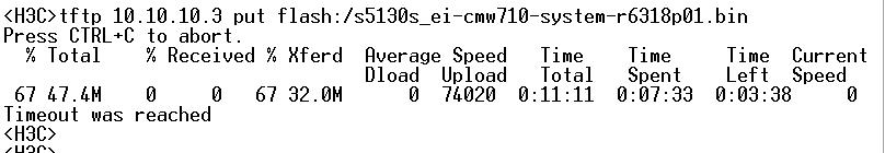

备份超时什么情况

这是备份,传到最后,不动了

dis logbuffer有日志反馈吗
得闲饮汤127 发表时间:2021-08-10
%Jan 1 00:13:21:135 2013 H3C SHELL/6/SHELL_CMD: -Line=aux0-IPAddr=**-User=**; C ommand is tftp 10.10.10.3 put flash:/s5130s_ei-cmw710-system-r6318p01.bin %Jan 1 00:25:47:195 2013 H3C IFNET/3/PHY_UPDOWN: Physical state on the interfac e GigabitEthernet1/0/1 changed to down. %Jan 1 00:25:47:211 2013 H3C IFNET/5/LINK_UPDOWN: Line protocol state on the in terface GigabitEthernet1/0/1 changed to down. %Jan 1 00:25:47:212 2013 H3C IFNET/3/PHY_UPDOWN: Physical state on the interfac e Vlan-interface1 changed to down. %Jan 1 00:25:47:216 2013 H3C IFNET/5/LINK_UPDOWN: Line protocol state on the in terface Vlan-interface1 changed to down. %Jan 1 00:29:46:788 2013 H3C SHELL/6/SHELL_CMD: -Line=aux0-IPAddr=**-User=**; C ommand is tftp 10.10.10.3 put flash:/s5130s_ei-cmw710-system-r6318p01.bin %Jan 1 00:29:53:479 2013 H3C IFNET/3/PHY_UPDOWN: Physical state on the interfac e GigabitEthernet1/0/1 changed to up. %Jan 1 00:29:53:502 2013 H3C IFNET/5/LINK_UPDOWN: Line protocol state on the in terface GigabitEthernet1/0/1 changed to up. %Jan 1 00:29:53:506 2013 H3C IFNET/3/PHY_UPDOWN: Physical state on the interfac e Vlan-interface1 changed to up. %Jan 1 00:29:53:510 2013 H3C IFNET/5/LINK_UPDOWN: Line protocol state on the in terface Vlan-interface1 changed to up. %Jan 1 00:30:24:205 2013 H3C STP/6/STP_DETECTED_TC: Instance 0's port GigabitEt hernet1/0/1 detected a topology change. %Jan 1 00:30:37:592 2013 H3C SHELL/6/SHELL_CMD: -Line=aux0-IPAddr=**-User=**; C ommand is system-view %Jan 1 00:30:45:000 2013 H3C SHELL/6/SHELL_CMD: -Line=aux0-IPAddr=**-User=**; C ommand is display current-configuration %Jan 1 00:31:27:173 2013 H3C SHELL/6/SHELL_CMD: -Line=aux0-IPAddr=**-User=**; C ommand is interface GigabitEthernet 1/0/1 %Jan 1 00:31:57:438 2013 H3C SHELL/6/SHELL_CMD: -Line=aux0-IPAddr=**-User=**; C ommand is quit %Jan 1 00:31:59:277 2013 H3C SHELL/6/SHELL_CMD: -Line=aux0-IPAddr=**-User=**; C ommand is quit %Jan 1 00:31:59:277 2013 H3C CFGMAN/5/CFGMAN_EXIT_FROM_CONFIGURE: -Line=aux0-IP Addr=**-User=**; Exit from the system view or a feature view to the user view. %Jan 1 00:32:30:771 2013 H3C SHELL/6/SHELL_CMD: -Line=aux0-IPAddr=**-User=**; C ommand is tftp 10.10.10.3 put flash:/s5130s_ei-cmw710-system-r6318p01.bin
发表时间:2021-08-10
您使用GI1/0/1端口么?
是的
发表时间:2021-08-10
我看到有GI1/0/1端口频繁UP DOWN的日志,物理链路的不稳定会影响文件的上传的。
没有那个是我自己试了几次,这个文件s5130s_ei-cmw710-boot-r6318p01.bin 成功备份,那个YSY系统文件就不行
发表时间:2021-08-10
换个浏览器再下载新的文件再次上传看下是否还出现这个问题吧,同时可采用WEB的方式上传看下是否还复现。
这个是从交换机传到电脑
发表时间:2021-08-10
换FTP GET
