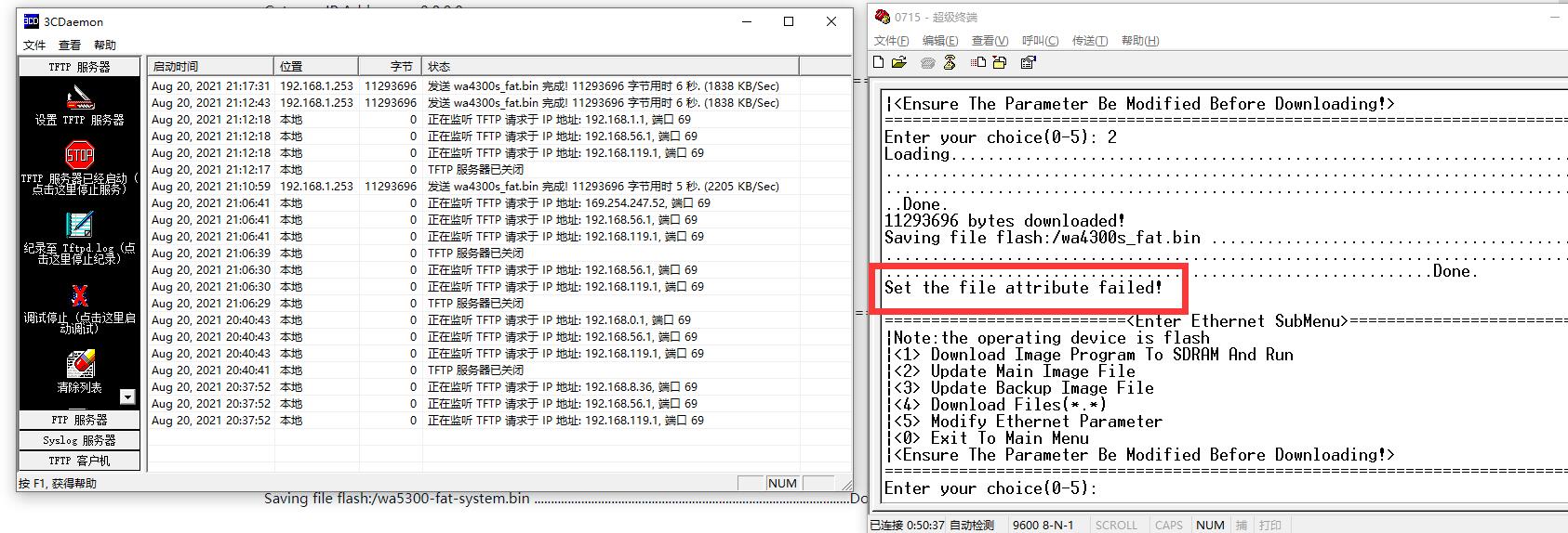

检查一下设备的BOOTWARE版本呢,如果是V7版本的瘦AP无法直接刷胖,要先降级BOOTWARE才行的
zhiliao_3eiE4 知了小白
* H3C WAP712C BootWare, Version 7.14 *

==========================<Enter Ethernet SubMenu>==========================
|Note:the operating device is flash |
|<1> Download Image Program To SDRAM And Run |
|<2> Update Main Image File |
|<3> Update Backup Image File |
|<4> Download Files(*.*) |
|<5> Modify Ethernet Parameter |
|<0> Exit To Main Menu |
|<Ensure The Parameter Be Modified Before Downloading!> |
Enter your choice(0-5): 2
Loading.....................................................................
..Done.
11293696 bytes downloaded!
Saving file flash:/wa4300s_fat.bin
The file is exist,will you overwrite it? [Y/N]Y.............................
.............................Done.
Set the file attribute failed!
..Done.
Saving file flash:/wa4300s_fat.bin .........................................
............................................................Done.

'M' = MAIN 'B' = BACKUP 'N/A' = NOT ASSIGNED
|NO. Size(B) Time Type Name |
|1 11293696 Aug/08/2008 20:00:00 N/A flash:/wa4300s_fat.bin |
===============================<File CONTROL>===============================
|<1> Display All File(s) |
|<2> Set Image File type |
|<3> Set Bin File type |
|<4> Set Configuration File type |
|<5> Delete File |
Enter your choice(0-5): 0
==========================<EXTENDED-BOOTWARE MENU>==========================
|<1> Boot System |
|<2> Enter Serial SubMenu |
|<3> Enter Ethernet SubMenu |
|<4> File Control |
|<5> Restore to Factory Default Configuration |
|<6> Skip Current System Configuration |
|<7> BootWare Operation Menu |
|<8> Skip Authentication for Console Login |
|<9> Storage Device Operation |
|<0> Reboot |
Ctrl+Z: Access EXTENDED ASSISTANT MENU
Ctrl+F: Format File System
Ctrl+C: Display Copyright
Ctrl+Y: Change AP Mode
Enter your choice(0-9): 0
System is starting...
Press Ctrl+D to access BASIC-BOOTWARE MENU
Booting Normal Extend BootWare
The Extend BootWare is self-decompressing.................................
Done!
Copyright (c) 2004-2018 New H3C Technologies Co., Ltd.
Compiled Date : Oct 15 2018
CPU Type : ATHEROS AR9563
CPU L1 Cache : 32KB
CPU Clock Speed : 775MHz
Memory Type : SDRAM
Memory Size : 128MB
Memory Speed : 560MHz
BootWare Size : 512KB
Flash Size : 16MB
PCB Version : Ver.A
BootWare Validating...
Press Ctrl+B to access EXTENDED-BOOTWARE MENU...
Loading the main boot and system image files...
The system image does not exist!
Loading the backup boot and system image files...
The image does not exist!
Booting image fails!
Trying to get the IP address from the DHCP server......
Getting IP Address Failed, the system will reboot.
[State : Idle] Reset request, rebooting the
Done!
CPU L1 Cache : 32KB
Memory Type : SDRAM
Memory Size : 128MB
Flash Size : 16MB
PCB Version : Ver.A
哪位技术大侠帮忙看看为什么不成功,帮忙教教我,谢谢!QQ3303375104
