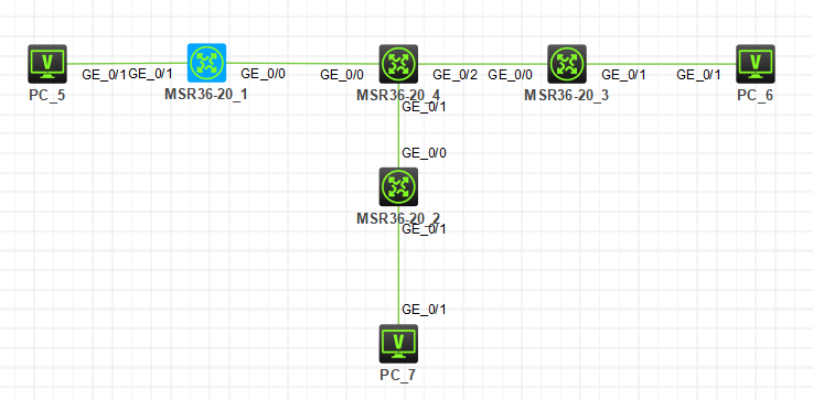

组网要求:
R1、R2、R3为与服务器连接的VTEP设备。虚拟机VM 1、VM 2和VM 3同属于VXLAN 10。通过VXLAN实现不同站点间的二层互联,确保虚拟机在站点之间进行迁移时用户的访问流量不会中断。

我在R1查看隧道状态如下:
[r1]dis interface Tunnel 12
 Tunnel12 Current state: DOWN Line protocol state: DOWN Description: 2.2.2.2 Bandwidth: 64 kbps Maximum transmission unit: 64000 Internet protocol processing: Disabled Output queue - Urgent queuing: Size/Length/Discards 0/1024/0 Output queue - Protocol queuing: Size/Length/Discards 0/500/0 Output queue - FIFO queuing: Size/Length/Discards 0/75/0 Last clearing of counters: Never Tunnel source 1.1.1.1, destination unknown Tunnel protocol/transport UDP_VXLAN/IP Last 300 seconds input rate: 0 bytes/sec, 0 bits/sec, 0 packets/sec Last 300 seconds output rate: 0 bytes/sec, 0 bits/sec, 0 packets/sec Input: 0 packets, 0 bytes, 0 drops Output: 0 packets, 0 bytes, 0 drops
