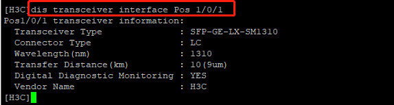

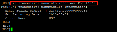

POS接口如何查看所插光模块的信息,参考代理商提供的display transceiver manuinfo interface后面无法跟POS接口

查看方法如图所示

以下是光模块相关信息的查询命令,请悉知:
[H3C]display transceiver manuinfo interface //查看光模块生产厂家信息
 [H3C]dis transceiver interface GigabitEthernet 1/0/1 //查看光模块的信息
[H3C]dis transceiver diagnosis interface GigabitEthernet 1/0/1 //查看光口的收发情况
 [H3C]dis transceiver alarm interface GigabitEthernet 1/0/1 //查看光口的告警信息
