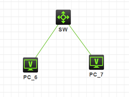

能提供 一个DHCPv6无状态配置案例吗,配置指导?
IPV6终端通过无DHCPv6无状态方式获取到IPv6地址,访问网络
interface Vlan-interface100
 ipv6 dhcp select server
 ipv6 dhcp server apply pool 100
 ipv6 address 2002::1/64
 ipv6 nd autoconfig other-flag
 undo ipv6 nd ra halt
ipv6 dhcp pool 100
 dns-server 2002::2
 port link-mode bridge
 port access vlan 100
PC端无法获取地址。
