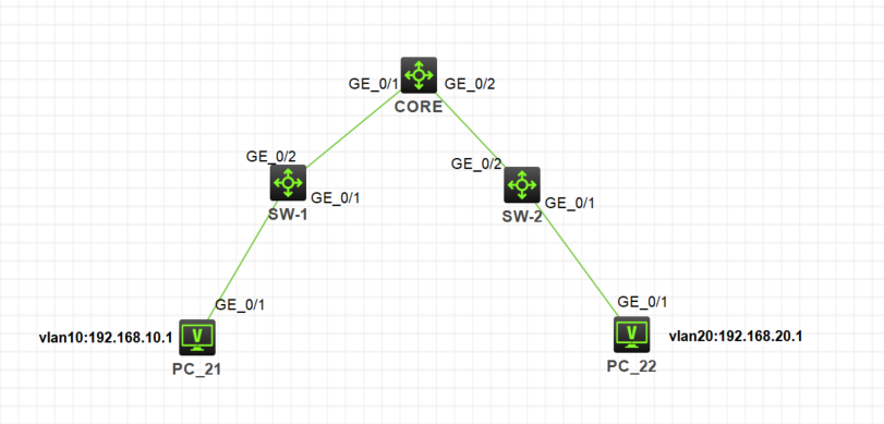

SW-1配置# interface Vlan-interface1 ip address 1.1.1.2 255.255.255.0
CORE配置# interface Vlan-interface1 ip address 1.1.1.1 255.255.255.0
PC_21可以ping 通1.1.1.1,但是无法ping通1.1.12
为什么?

PC_21配置:
IP:192.168.10.1/24
网关:192.168.10.254
PC_22配置:
IP:192.168.20.1/24
网关:192.168.20.254
SW-1配置:
# vlan 1
# vlan 10
# stp global enable
# interface GigabitEthernet1/0/1
 port link-mode bridge
 port access vlan 10
 combo enable fiber
# interface GigabitEthernet1/0/2
 port link-type trunk
 port trunk permit vlan all
 combo enable fiber
SW-2配置:
# vlan 1
# vlan 20
# stp global enable
 port access vlan 20
 combo enable fiber
 combo enable fiber
CORE配置:
# vlan 1
# vlan 10
# vlan 20
# stp global enable
# interface Vlan-interface10
 ip address 192.168.10.254 255.255.255.0
# interface Vlan-interface20
 ip address 192.168.20.254 255.255.255.0
 combo enable fiber
 combo enable fiber

PC_21可以ping 通1.1.1.1,但是无法ping通1.1.1.2 ,以下是排查要点,请参考:
 1、检查相关设备是否已创建了VLAN。
2、检查互联设备的端口是否划分了VLAN进来。
3、SW1配置默认路由指向到core:
ip route-static 0.0.0.0 0.0.0.0 1.1.1.1
