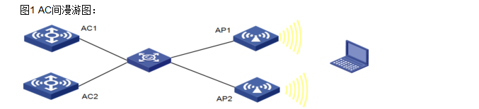

如图1所示,Switch作为DHCP服务器为AP和Client分配IP地址,两台AC互为主备:
·在AC上配置vlan-group,让客户端在两台AC之间实现漫游。
·AP1注册到AC1和AC2,AC1为主;AP2注册到AC1和AC2,AC2为主。
图1 AC间漫游图:

interface Vlan-interface2
 ip address 192.12.0.1 255.255.0.0
interface Vlan-interface10
 ip address 192.10.0.1 255.255.0.0
interface Vlan-interface20
 ip address 192.20.0.1 255.255.0.0
interface Vlan-interface30
 ip address 192.30.0.1 255.255.0.0
interface Vlan-interface40
 ip address 192.40.0.1 255.255.0.0
 port link-type trunk
 port trunk permit vlan 2 10 20 30 40
