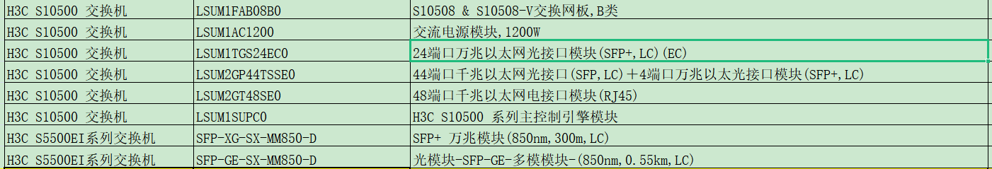

这个板卡接口是Ten-GigabitEthernet 1/0/1还是Ten-GigabitEthernet 1/0/0/1
您好,Ten-GigabitEthernet 1/0/1
粉丝:50人 关注:1人
单台设备是Ten-GigabitEthernet 1/0/1
堆叠后是Ten-GigabitEthernet 1/1/0/1
drni不影响接口,还是Ten-GigabitEthernet 1/0/1
zhiliao_zhui 发表时间:2021-09-02 更多>>
做的drni,应该是Ten-GigabitEthernet 1/0/1吧
zhiliao_kSs43h 发表时间:2021-09-02
