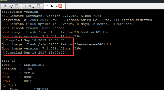

F1060和F1090的区别

F1060和F1090 的配置都如下(除了IP地址不同),但是F1060就能ping通,F1090就是无法ping通:
interface GigabitEthernet1/0/10
port link-mode route
combo enable copper
ip address 10.1.2.2 255.255.255.0
interface GigabitEthernet1/0/11
combo enable copper
ip address 10.1.3.2 255.255.255.0
security-zone name Local
security-zone name Trust
import interface GigabitEthernet1/0/10
security-zone name DMZ
security-zone name Untrust
import interface GigabitEthernet1/0/11
security-zone name Management
zone-pair security source Any destination Local
packet-filter 3000
zone-pair security source Local destination Any
packet-filter 3000
acl advanced 3000
rule 0 permit ip
