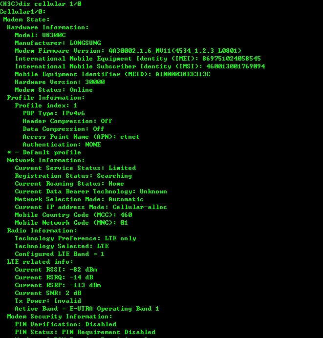

单位的设备,前段时间VPN建立不了连接了,于是查找原因,结果发现在拨号也很困难,一直拨号失败,配置没变,最多就是切LTE,AUTO。SIM卡是联通4G卡,插手机里4G正常,上网正常,百思不得其解,截图是cellur1/0接口的信息,下面的有debug的dialer的LOG,麻烦给看一下有什么问题,谢谢
*Jan 1 01:04:43:470 2011 H3C DDR/7/EVENT: Found free channel on interface Eth-channel1/0:0, and trying to dia l with it. *Jan 1 01:04:43:470 2011 H3C DDR/7/EVENT: Dialing *99# on interface Eth-channel1/0:0, with user ID 0. *Jan 1 01:05:43:470 2011 H3C DDR/7/EVENT: Wait-carrier timer timed out on interface Eth-channel1/0:0, and cal l disconnected. *Jan 1 01:05:43:470 2011 H3C DDR/7/EVENT: Disconnecting link-call on interface N/A. *Jan 1 01:05:43:470 2011 H3C DDR/7/EVENT: Disconnecting call on interface Eth-channel1/0:0, with user ID 0 an d call ID 65535. *Jan 1 01:05:48:470 2011 H3C DDR/7/EVENT: Enable timer timed out on interface Eth-channel1/0:0. *Jan 1 01:05:48:470 2011 H3C DDR/7/EVENT: Auto dial timer timed out, and trying to dial on interface Eth-chan nel1/0:0. *Jan 1 01:05:48:470 2011 H3C DDR/7/EVENT: Found free channel on interface Eth-channel1/0:0, and trying to dia l with it. *Jan 1 01:05:48:470 2011 H3C DDR/7/EVENT: Dialing *99# on interface Eth-channel1/0:0, with user ID 0. *Jan 1 01:06:48:470 2011 H3C DDR/7/EVENT: Wait-carrier timer timed out on interface Eth-channel1/0:0, and cal l disconnected. *Jan 1 01:06:48:470 2011 H3C DDR/7/EVENT: Disconnecting link-call on interface N/A. *Jan 1 01:06:48:470 2011 H3C DDR/7/EVENT: Disconnecting call on interface Eth-channel1/0:0, with user ID 0 an d call ID 65535. *Jan 1 01:06:53:470 2011 H3C DDR/7/EVENT: Enable timer timed out on interface Eth-channel1/0:0. *Jan 1 01:06:53:470 2011 H3C DDR/7/EVENT: Auto dial timer timed out, and trying to dial on interface Eth-chan nel1/0:0. *Jan 1 01:06:53:470 2011 H3C DDR/7/EVENT: Found free channel on interface Eth-channel1/0:0, and trying to dia l with it. *Jan 1 01:06:53:470 2011 H3C DDR/7/EVENT: Dialing *99# on interface Eth-channel1/0:0, with user ID 0.
联通的卡,apn应该是3gnet,不是ctnet
另外,4G信号-113,也不是很好,可以换个地方试试,把APN改成3gnet
粉丝:12人 关注:8人
APN不对,现在服务受限,4G信号RSRP是-113dBm,有点弱了,最低不能超过-105dBm

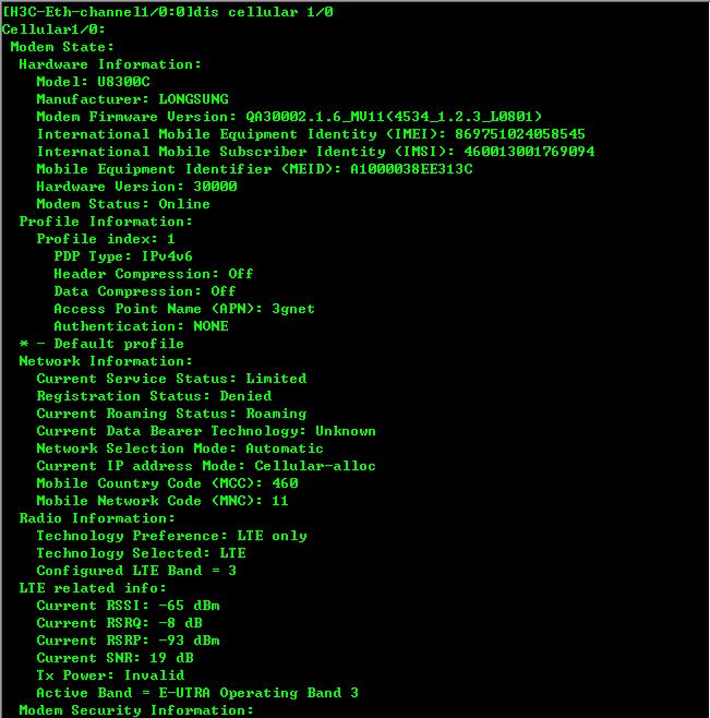

按照上面说的,1.我新建了一个APN模板,并应用到eth拨号接口里,现在是3GNET;2.同样的位置卡在手里上网很正常,信息不是满格但速度很快,位置现在是在最靠窗的位置了,没办法再换其它位置了;3.   4G的频段我换了换,发现band3信号强度算是比较好,应该够用。
做了如上方法,在log里仍然是timeout,设备以前放在集团时,在4G信号很不好的时候配置 mode为auto,会自动用3G连上网,速度不是太快但VPN足够建立成功并打开内网,现在设备拿回公司,有4G信号,但lte与auto都不能拨号成功,之前没有专门配置apn,但是却能拨号成功,我感觉要么是信号强度不够,要么是公司风水不好,或者请帮我分析下是否还有其它原因?谢谢了
