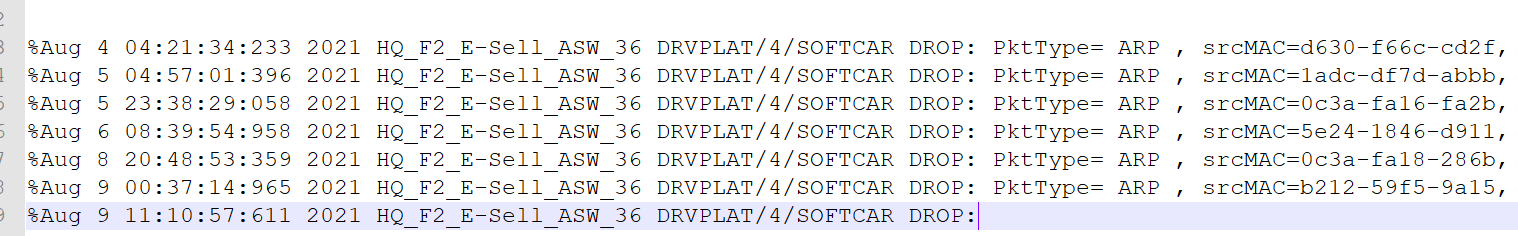

各位大神:这个日志是什么情况
%Aug 4 04:21:34:233 2021 HQ_F2_E-Sell_ASW_36 DRVPLAT/4/SOFTCAR DROP: PktType= ARP , srcMAC=d630-f66c-cd2f, Drop From Interface=GE1/0/16 at Stage=59, StageCnt=236 TotalCnt=6817, Max Rate Interface=GE1/0/16 !!
%Aug 5 04:57:01:396 2021 HQ_F2_E-Sell_ASW_36 DRVPLAT/4/SOFTCAR DROP: PktType= ARP , srcMAC=1adc-df7d-abbb, Drop From Interface=GE1/0/16 at Stage=0, StageCnt=1 TotalCnt=1, Max Rate Interface=GE1/0/16 !!
%Aug 5 23:38:29:058 2021 HQ_F2_E-Sell_ASW_36 DRVPLAT/4/SOFTCAR DROP: PktType= ARP , srcMAC=0c3a-fa16-fa2b, Drop From Interface=GE1/0/16 at Stage=0, StageCnt=162 TotalCnt=163, Max Rate Interface=GE1/0/16 !!
%Aug 6 08:39:54:958 2021 HQ_F2_E-Sell_ASW_36 DRVPLAT/4/SOFTCAR DROP: PktType= ARP , srcMAC=5e24-1846-d911, Drop From Interface=GE1/0/16 at Stage=0, StageCnt=162 TotalCnt=325, Max Rate Interface=GE1/0/16 !!
%Aug 8 20:48:53:359 2021 HQ_F2_E-Sell_ASW_36 DRVPLAT/4/SOFTCAR DROP: PktType= ARP , srcMAC=0c3a-fa18-286b, Drop From Interface=GE1/0/16 at Stage=0, StageCnt=1 TotalCnt=1, Max Rate Interface=GE1/0/16 !!
%Aug 9 00:37:14:965 2021 HQ_F2_E-Sell_ASW_36 DRVPLAT/4/SOFTCAR DROP: PktType= ARP , srcMAC=b212-59f5-9a15, Drop From Interface=GE1/0/16 at Stage=0, StageCnt=146 TotalCnt=147, Max Rate Interface=GE1/0/16 !!
 %Aug 9 11:10:57:611 2021 HQ_F2_E-Sell_ASW_36 DRVPLAT/4/SOFTCAR DROP:

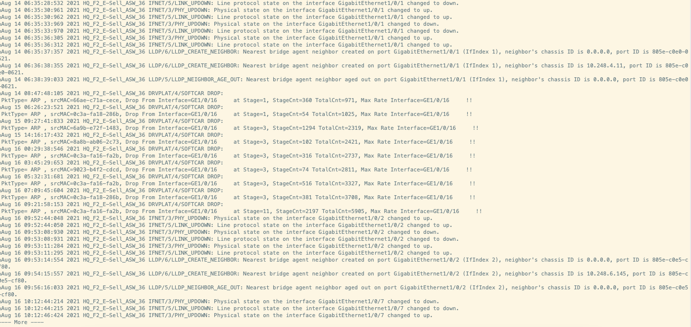

上连口 16口
超过限速之后丢包

说明你下面接的设备有大量的arp报文发送  超过交换机接口的限速了

ARP超限速被丢弃了,

不是很频繁的发生,大概一天一次的样子
看下这个接口下是不是配置ARP限速之类的配置了,或者就是PC在做扫描,看下对应的MAC地址是谁
不是太频繁,应该不影响业务,可以无视
