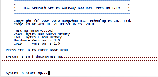

<H3C>reset saved-configuration
The saved configuration file will be erased. Are you sure? [Y/N]:Y  //确定删除保存的配置文件
<H3C>reboot
 Start to check configuration with next startup configuration file, please wait.........DONE!
 This command will reboot the device. Current configuration will be lost, save current configuration? [Y/N]:N  //不保存配置
This command will reboot the device. Continue? [Y/N]:Y   //继续重启
确认后,设备将恢复到出厂设置并重新启动。

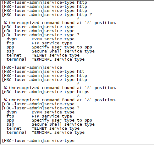

service-type 命令中没有对应HTTP
zhiliao_j42Fu5 发表时间:2021-09-15
zhiliao_j42Fu5 知了小白
命令图片

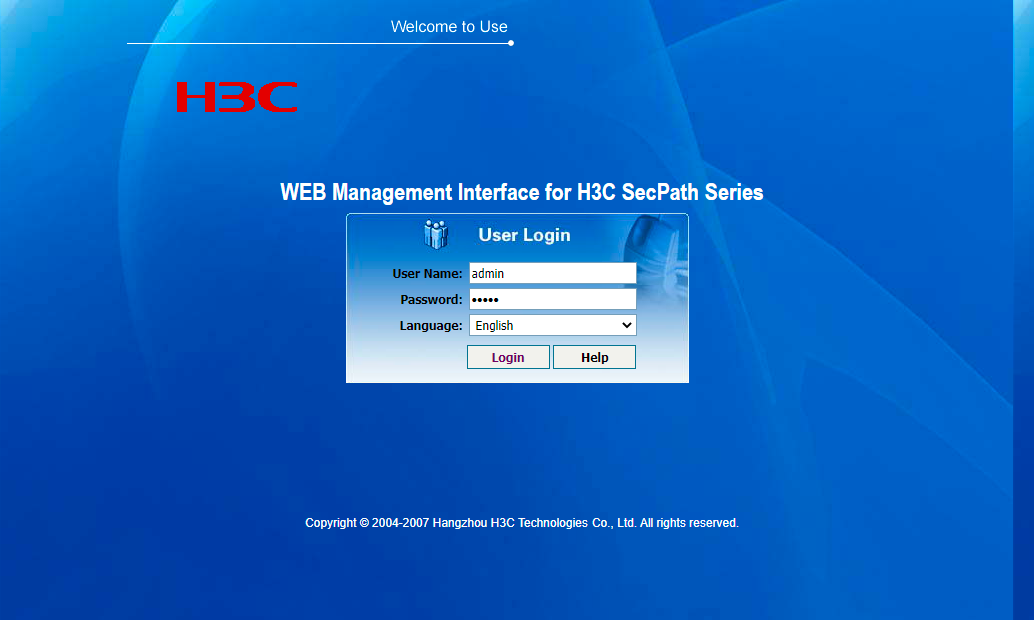

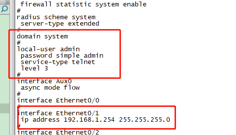

zhiliao_j42Fu5 知了小白
有登录界面后输入 admin admin 登录无任何提示,请问是浏览器问题 还是账号密码不对?
