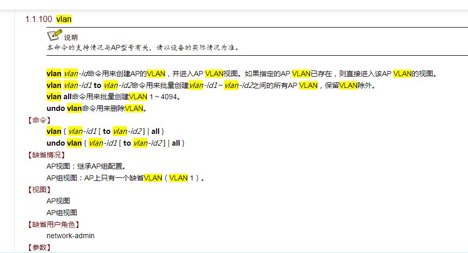

为AP(test)创建vlan  1000
参照:https://www.h3c.com/cn/d_202103/1391993_30005_0.htm#_Toc66779011
