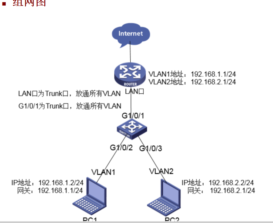

为什么单臂路由,路由器上接口封装了子vlan,创建了vlan就不通,删除了vlan就通了
米多 七段
粉丝:5人 关注:0人
路由器的子接口对应的是交换机的vlan的,正常交换机如果trunk上来vlan,路由器需要用子接口终结vlan
如果交换是access口的话,路由器用物理口对接就可以了
粉丝:7人 关注:8人
参考如下:
3.    配置步骤
3.1路由器端配置
#创建vlan
<H3C> system-view
[H3C] interface vlan 2
#配置虚接口地址,作为PC的网关
[H3C]interface  Vlan-interface 1
[H3C-Vlan-interface1] ip address 192.168.1.1 24
[H3C-Vlan-interface1] interface Vlan-interface 2
[H3C-Vlan-interface2]ip address 192.168.2.1 24
[H3C-Vlan-interface2]quit
#将与交换机互连的接口配置成trunk口,并放通所有vlan
[H3C]interface GigabitEthernet 0/2
[H3C-GigabitEthernet0/2]port link-type trunk
[H3C-GigabitEthernet0/2]port trunk  permit vlan all
#保存配置
[H3C]save force
3.2交换机端的配置
#创建vlan
<H3C>system-view
[H3C]interface vlan 2
#将连接路由器的接口切换成trunk口,并放通所有vlan
[H3C]interface  GigabitEthernet 1/0/1
[H3C-GigabitEthernet1/0/1]port link-type trunk
[H3C-GigabitEthernet1/0/1]port trunk permit vlan all
[H3C-GigabitEthernet1/0/1]quit
#将连接PC1和PC2接口划分到相应的vlan中
[H3C]interface GigabitEthernet 1/0/2
[H3C-GigabitEthernet1/0/2] port access vlan 1
[H3C-GigabitEthernet1/0/2] interface GigabitEthernet 1/0/3
[H3C-GigabitEthernet1/0/2] port access vlan 2
#保存配置
[H3C]save force
