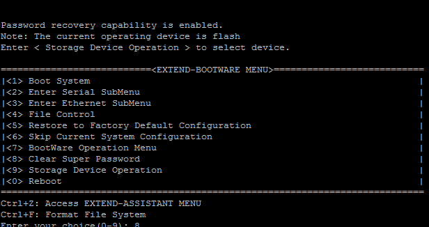

想要恢复出厂设置,老是提示需要关闭 恢复密码设置,但是不知道从哪里关闭
先选6跳过当前配置,然后选0重启。
进入bootroom菜单清除Consle密码 通过conlse线和crt软件连接并登陆设备,然后把设备断电重启。控制台上会打印如下信息,当出现“press Ctrl+B”的时候快速按住“Ctrl+B” 进入botroom菜单 System is starting... Press Ctrl+D to access BASIC-BOOTWARE MENU Booting Normal Extend BootWare The Extend BootWare is self-decompressing.......................Done! BootWare Validating... Press Ctrl+B to enter extended boot menu... BotWare password: Not required. Please press Enter to continue. Password recovery capability is enabled. Note: The current operating device is flash Enter < Storage Device Operation > to select device. 按住“Ctrl+B”进入如下菜单。选择“<6> Skip Current System Configuration”跳过当前配置启动,不同设备可能不是数字6, ===========================<EXTEND-BOOTWARE MENU>=========================== |<1> Boot System | |<2> Enter Serial SubMenu | |<3> Enter Ethernet SubMenu | |<4> File Control | |<5> Restore to Factory Default Configuration | |<6> Skip Current System Configuration | |<7> BootWare Operation Menu | |<8> Clear Super Password | |<9> Storage Device Operation | |<0> Reboot | ============================================================================ Ctrl+Z: Access EXTEND-ASSISTANT MENU Ctrl+F: Format File System Enter your choice(0-9): 6 Flag Set Success. 然后输入0重启设备 ===========================<EXTEND-BOOTWARE MENU>=========================== |<1> Boot System | |<2> Enter Serial SubMenu | |<3> Enter Ethernet SubMenu | |<4> File Control | |<5> Restore to Factory Default Configuration | |<6> Skip Current System Configuration | |<7> BootWare Operation Menu | |<8> Clear Super Password | |<9> Storage Device Operation | |<0> Reboot | ============================================================================ Ctrl+Z: Access EXTEND-ASSISTANT MENU Ctrl+F: Format File System Enter your choice(0-9): 0 System is starting... Press ENTER to get started. 3.2 如果不需要之前的配置信息的话 操作步骤:跳过启动文件后直接保存当前配置,再重启。 <H3C>save The current configuration will be written to the device. Are you sure? [Y/N]:y Please input the file name(*.cfg)[flash:/startup.cfg] (To leave the existing filename unchanged, press the enter key):(输入回车) flash:/startup.cfg exists, overwrite? [Y/N]:y Validating file. Please wait... Configuration is saved to device successfully. <H3C>reboot Start to check configuration with next startup configuration file, please wait.........DONE! Current configuration may be lost after the reboot, save current configuration? [Y/N]:y This command will reboot the device. Continue? [Y/N]:y 3.3 如果需要之前的配置信息的话 <H3C> #Apr 26 12:02:07:166 2000 H3C SHELL/4/LOGIN: Trap 1.3.6.1.4.1.25506.2.2.1.1.3.0.1<hh3cLogIn>: login from Console %Apr 26 12:02:07:306 2000 H3C SHELL/5/SHELL_LOGIN: Console logged in from aux0. <H3C>dir %查看设备配置文件 Directory of flash:/ 1 drw- - Apr 26 2000 12:00:20 logfile 2 -rw- 1666 Apr 26 2000 12:05:39 startup.cfg 3 -rw- 1556 Apr 26 2000 12:05:33 _startup_bak.cfg 4 -rw- 151 Apr 26 2000 12:05:30 system.xml 29106 KB total (16876 KB free) 给设备和电脑配置成同网段IP地址(举例:WAC配置成192.168.100.1,电脑配置成192.168.100.2),在电脑上通过3CD软件搭建tftp服务器。 <H3C>sys System View: return to User View with Ctrl+Z. [H3C]interface Vlan-interface 1 [H3C-Vlan-interface1]ip address 192.168.100.1 24 [H3C-Vlan-interface1]quit [H3C]ping 192.168.100.2 PING 192.168.100.2: 56 data bytes, press CTRL_C to break Reply from 192.168.100.2: bytes=56 Sequence=1 ttl=128 time=7 ms Reply from 192.168.100.2: bytes=56 Sequence=2 ttl=128 time=2 ms <H3C>tftp 192.168.100.2 put startup.cfg File will be transferred in binary mode Sending file to remote TFTP server. Please wait... | TFTP: 1666 bytes sent in 0 second(s). File uploaded successfully. <H3C> 下载成功: 可以到本地相关路径(此例子中是E盘)查看到相关文件。 需要恢复之前配置 解决方法:删除密码恢复之前配置文件 使用记事本打开startup.cfg文件 删除aux0口下的认证方式和密码并保存文件 覆盖当前配置文件 <H3C>tftp 192.168.100.20 get startup.cfg The file startup.cfg exists. Overwrite it? [Y/N]:y Verifying server file... Deleting the old file, please wait... ... File will be transferred in binary mode Downloading file from remote TFTP server, please wait.... TFTP: 1166 bytes received in 0 second(s) File downloaded successfully. <H3C>reboot Start to check configuration with next startup configuration file, please wait.........DONE! Current configuration may be lost after the reboot, save current configuration? [Y/N]:n 不保存配置 This command will reboot the device. Continue? [Y/N]:y 确定继续重启

但是结果还是会跳到这个界面。。。
zhiliao_iiTrbS 发表时间:2021-11-01

关键是进不了系统,先当做普通交换机都用不了,网口插上去灯都不亮
