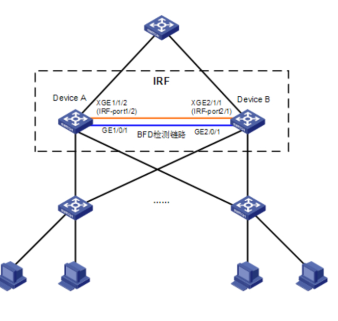

三台设备互联    各取一根线做mad bfd检测
组网图
3 配置步骤

3.2  配置BFD MAD
# 创建VLAN 3,并将Device A上的端口GigabitEthernet1/0/1和Device B上的端口GigabitEthernet2/0/1加入VLAN3中。
<DeviceA> system-view
[DeviceA] vlan 3
[DeviceA-vlan3] port gigabitethernet 1/0/1 gigabitethernet 2/0/1
[DeviceA-vlan3] quit
# 创建VLAN接口3,并配置MAD IP地址。
[DeviceA] interface vlan-interface 3
[DeviceA-Vlan-interface3] mad bfd enable
[DeviceA-Vlan-interface3] mad ip address 192.168.2.1 24 member 1
[DeviceA-Vlan-interface3] mad ip address 192.168.2.2 24 member 2
[DeviceA-Vlan-interface3] quit
# 因为BFD MAD和生成树功能互斥,所以在GigabitEthernet1/0/1和GigabitEthernet2/0/1上关闭生成树协议。
[Sysname] interface gigabitethernet 1/0/1
[Sysname-gigabitethernet1/0/1] undo stp enable
[Sysname-gigabitethernet1/0/1] quit
[Sysname] interface gigabitethernet 2/0/1
[Sysname-gigabitethernet2/0/1] undo stp enable
3.3  保存配置
save force
3.4  实验结果验证
[H3C]display  mad
MAD ARP disabled.
MAD ND disabled.
MAD LACP disabled.
MAD BFD enabled.
[H3C]display mad verbose
Multi-active recovery state: No
Excluded ports (user-configured):
Excluded ports (system-configured):
 Ten-GigabitEthernet1/1/2
 Ten-GigabitEthernet2/1/1
MAD ARP disabled.
MAD ND disabled.
MAD LACP disabled.
MAD BFD enabled interface: Vlan-interface3
  MAD status                 : Faulty          \\MAD状态为:Faulty状态说明堆叠分裂
  Member ID   MAD IP address       Neighbor   MAD status
  1           192.168.2.1/24      2          Faulty
此时使用“display interface brief down”查看端口时发现端口全部被关闭,状态为mad shutdown
<H3C>display interface brief down
Brief information on interfaces in route mode:
Link: ADM - administratively down; Stby - standby
Interface            Link   Cause
GE2/0/2              DOWN   MAD ShutDown
GE2/0/3              DOWN   MAD ShutDown
