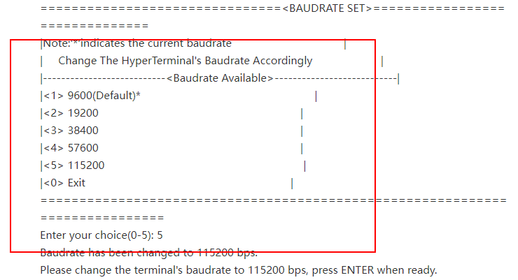

===============================<BAUDRATE SET>===============================
|Note:'*'indicates the current baudrate                                    |
|     Change The HyperTerminal's Baudrate Accordingly                      |
|---------------------------<Baudrate Available>---------------------------|
|<1> 9600(Default)*                                                        |
|<2> 19200                                                                 |
|<3> 38400                                                                 |
|<4> 57600                                                                 |
|<5> 115200                                                                |
|<0> Exit                                                                  |
Enter your choice(0-5): 5
Baudrate has been changed to 115200 bps.
Please change the terminal's baudrate to 115200 bps, press ENTER when ready.
The current baudrate is 115200 bps

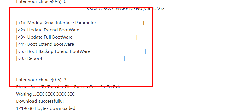

======================<BASIC-BOOTWARE MENU(Ver 1.22)>=======================
|<1> Modify Serial Interface Parameter                                     |
|<2> Update Extend BootWare                                                |
|<3> Update Full BootWare                                                  |
|<4> Boot Extend BootWare                                                  |
|<5> Boot Backup Extend BootWare                                           |
|<0> Reboot                                                                |
Enter your choice(0-5): 3
Please Start To Transfer File, Press <Ctrl+C> To Exit.
Waiting ...CCCCCCCCCCCCCC
Download successfully!
12196864 bytes downloaded!
Updating Basic BootWare? [Y/N]Y

1、上面这个应该怎么选
2、这个刷固件的过程是否正确
3、为什么刷了好几次,还是不开机
4、正常情况下,刷后再次启动大约要几分钟
谢谢!!!

第二部选择 1
这一步选择1  上传版本文件后,再执行3
