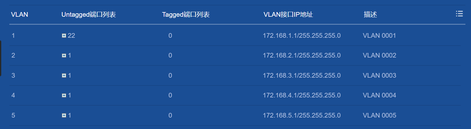

vlan配置如下
接口配置如下

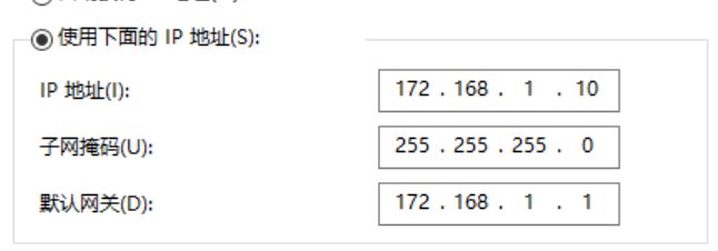

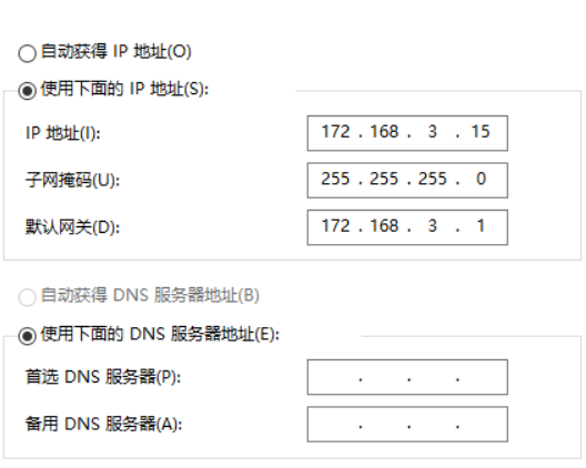

电脑配置
请问如何使这两台电脑能相互访问呢,目前回答都说网关在同一台设备上,vlan默认就是通的,但是现在我测试是不能访问的。

在172.168.1.10的电脑 ping172.168.3.1 也不通
zhiliao_Xbc9Oi 发表时间:2021-11-24

ping不通网关,没有配置acl策略,

配置问题,配置发一下看下
红烧牛肉面 发表时间:2021-11-24
# version 7.1.070, Release 6312P01 # sysname H3C # irf mac-address persistent timer irf auto-update enable undo irf link-delay irf member 1 priority 1 # lldp global enable # password-recovery enable # vlan 1 # vlan 2 to 5 # vlan 7 to 4094 # stp global enable # interface NULL0 # interface Vlan-interface1 ip address 172.168.1.1 255.255.255.0 dhcp client identifier ascii 58c7acfc4fd0-VLAN0001 # interface Vlan-interface2 ip address 172.168.2.1 255.255.255.0 # interface Vlan-interface3 ip address 172.168.3.1 255.255.255.0 # interface Vlan-interface4 ip address 172.168.4.1 255.255.255.0 # interface Vlan-interface5 ip address 172.168.5.1 255.255.255.0 # interface GigabitEthernet1/0/6 port link-mode route ip address 172.168.6.1 255.255.255.0 # interface GigabitEthernet1/0/7 port link-mode route ip address 172.168.7.1 255.255.255.0 # interface GigabitEthernet1/0/1 port link-mode bridge # interface GigabitEthernet1/0/2 port link-mode bridge port access vlan 2 # interface GigabitEthernet1/0/3 port link-mode bridge port access vlan 3 # interface GigabitEthernet1/0/4 port link-mode bridge port access vlan 4 # interface GigabitEthernet1/0/5 port link-mode bridge port access vlan 5 # interface GigabitEthernet1/0/8 port link-mode bridge # interface GigabitEthernet1/0/9 port link-mode bridge # interface GigabitEthernet1/0/10 port link-mode bridge # interface GigabitEthernet1/0/11 port link-mode bridge # interface GigabitEthernet1/0/12 port link-mode bridge # interface GigabitEthernet1/0/13 port link-mode bridge # interface GigabitEthernet1/0/14 port link-mode bridge # interface GigabitEthernet1/0/15 port link-mode bridge # interface GigabitEthernet1/0/16 port link-mode bridge # interface GigabitEthernet1/0/17 port link-mode bridge combo enable auto # interface GigabitEthernet1/0/18 port link-mode bridge combo enable auto # interface GigabitEthernet1/0/19 port link-mode bridge combo enable auto # interface GigabitEthernet1/0/20 port link-mode bridge combo enable auto # interface GigabitEthernet1/0/21 port link-mode bridge combo enable auto # interface GigabitEthernet1/0/22 port link-mode bridge combo enable auto # interface GigabitEthernet1/0/23 port link-mode bridge combo enable auto # interface GigabitEthernet1/0/24 port link-mode bridge combo enable auto # interface M-GigabitEthernet0/0/0 # interface Ten-GigabitEthernet1/0/25 port link-mode bridge # interface Ten-GigabitEthernet1/0/26 port link-mode bridge # interface Ten-GigabitEthernet1/0/27 port link-mode bridge # interface Ten-GigabitEthernet1/0/28 port link-mode bridge # scheduler logfile size 16 # line class aux user-role network-admin # line class usb user-role network-admin # line class vty user-role network-operator # line aux 0 user-role network-admin # line vty 0 63 user-role network-operator # radius scheme system user-name-format without-domain # domain system # domain default enable system # role name level-0 description Predefined level-0 role # role name level-1 description Predefined level-1 role # role name level-2 description Predefined level-2 role # role name level-3 description Predefined level-3 role # role name level-4 description Predefined level-4 role # role name level-5 description Predefined level-5 role # role name level-6 description Predefined level-6 role # role name level-7 description Predefined level-7 role # role name level-8 description Predefined level-8 role # role name level-9 description Predefined level-9 role # role name level-10 description Predefined level-10 role # role name level-11 description Predefined level-11 role # role name level-12 description Predefined level-12 role # role name level-13 description Predefined level-13 role # role name level-14 description Predefined level-14 role # user-group system # local-user admin class manage password hash $h$6$1JNRlvOTwf+9RbHL$+fgjnUonDCHPjJFPwsGN63Uw+Sl6lYHyoIwAPIALCOtTtXnupAkkh4JyCzD8vouUPGRMthtY6MDt/kVOdOaiYQ== service-type http https authorization-attribute user-role network-admin authorization-attribute user-role network-operator # ip http enable ip https enable # cloud-management server domain oasis.h3c.com # return
配置没问题。配置清掉重新配置吧,理论上这样就通了
感谢帮助,原来是需要禁用WIFI就行了
