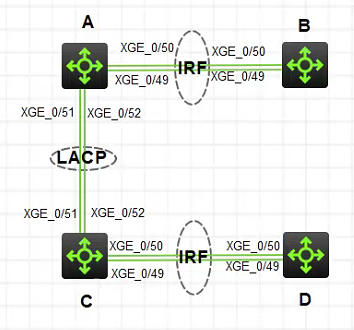

交换机A与B,C与D堆叠 ,
A堆叠 与 D堆叠 进行静态链路汇聚 ; A与D 有相同VLAN 10  20  30
先进行A堆叠 1/0/51 to 1/0/52   与   D堆叠1/0/51 to 2/0/52 端口 ;
两边端口配置为[A-Bridge-Aggregation1]dis this
interface Bridge-Aggregation1
 port link-type trunk
 port trunk permit vlan all
return
 [D-Bridge-Aggregation1]dis this
return
A堆叠能够把2/0/51 to 2/0/52 配置进入 port link-aggregation group 1 中
 [A-if-range]dis this
interface Ten-GigabitEthernet2/0/51
 port link-mode bridge combo enable fiber
但是D堆叠加入时提示
[D-if-range]port link-aggregation group 1
 Can't assign the port to the aggregation group because its attribute configurations are different than the aggregate interface.
这个知识点未学习到,希望大佬伸出援手帮小弟解答一二,谢谢!

配置链路聚合的顺序不对。接到接口把配置都def掉,恢复初始状态,然后按这个配置来
int Bridge-Aggregation1
int g0/0/0
int g0/0/1
int Bridge-Aggregation 1
把物理口的配置清空,在加入聚合组
