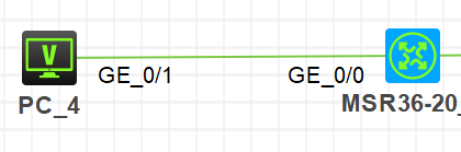

开启DHCP Snooping后还可以获取地址,请问是为什么,望告知,谢谢!
配置:
dhcp enable
dhcp snooping enable
dhcp server ip-pool xy
 gateway-list 10.135.173.1
 network 10.135.173.0 mask 255.255.255.0
 address range 10.135.173.110 10.135.173.112
 dns-list 211.138.240.100 211.138.245.180 114.114.114.114
[H3C-GigabitEthernet0/0]dis th
interface GigabitEthernet0/0
 port link-mode bridge
 port access vlan 20
 dhcp snooping binding record
[H3C-Vlan-interface20]dis th
interface Vlan-interface20
 ip address 10.135.173.113 255.255.255.0
 ip address 10.135.177.88 255.255.254.0 sub
