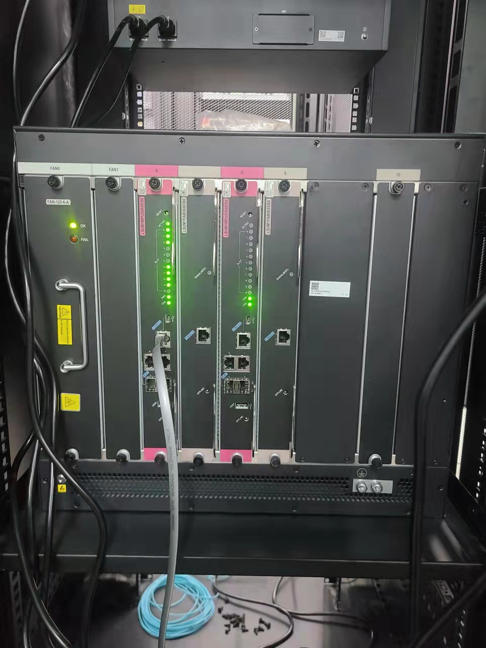

设备一致报这个,是我板卡差错了吗?
%Dec 1 15:42:05:611 2021 H3C DRVPLAT/4/DrvDebug: -MDC=1;
A switching fabric module was installed in the first switching fabric module slot while the second, or third switching fabric module slot was empty. Please move the module to one of the specified slots that are empty.

对于S10506X交换机,如果需要安装交换网板,请优先安装至编号为9、10的槽位,编号为7的槽位仅当满配交换网板时使用
粉丝:16人 关注:2人
请参考华三官网的安装手册:https://www.h3c.com/cn/d_202108/1436540_30005_0.htm#_Toc79435888
